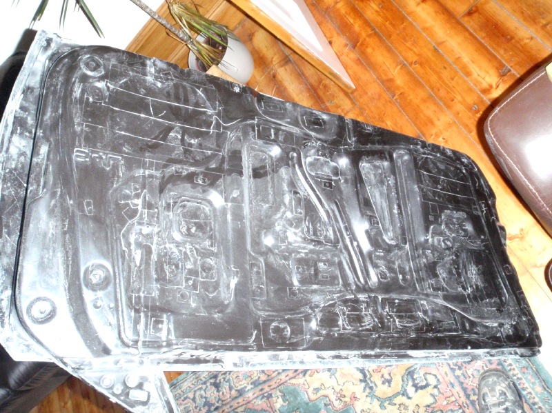

Light Weight GRP doors in black gell coat arrived :lick:
Weighed them to make sure... 6kg Each! hehe
Just waiting for the GRP boot skin and Lexan windows now.

Have you wieghed the original doors?
22nd Jan 09 at 14:57   View Garage View User's Profile U2U Member Reply With Quote
6kg Such a good thread this.
AK
Registered: 5th Jul 00
Location: Aberdeen City
22nd Jan 09 at 15:12   View User's Profile U2U Member Reply With Quote
read somewhere on GTRoc that they are 26kg without glass. Thats the electrics/mirrors i presume included.
Will weight them once off.

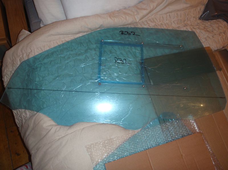

windows

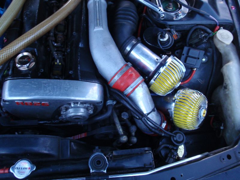

filters on, AFMS removed, and 'blanks' fitted in their place

your apexi d-jetro then Adam?
AK
7th Mar 09 at 12:50   View User's Profile U2U Member Reply With Quote
yup, twin MAP sensors tapped into throttle bodies

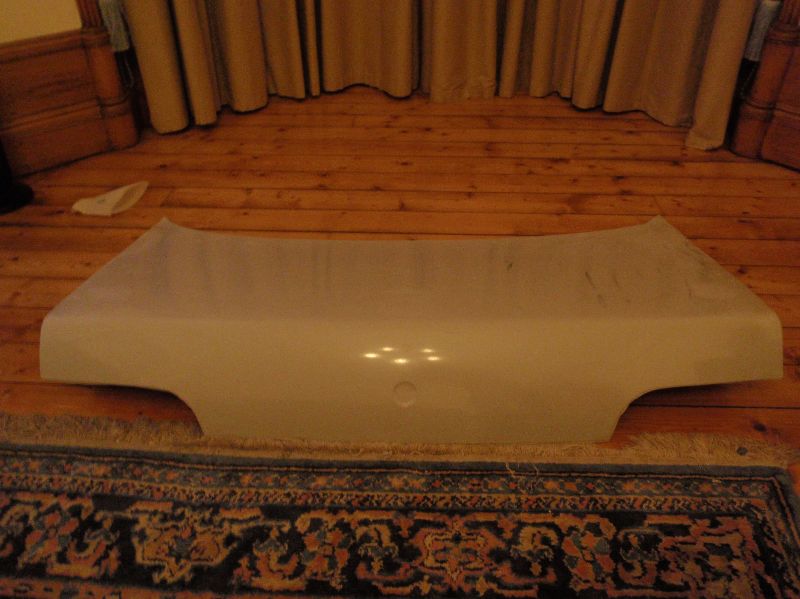

superdooper lightweight boot

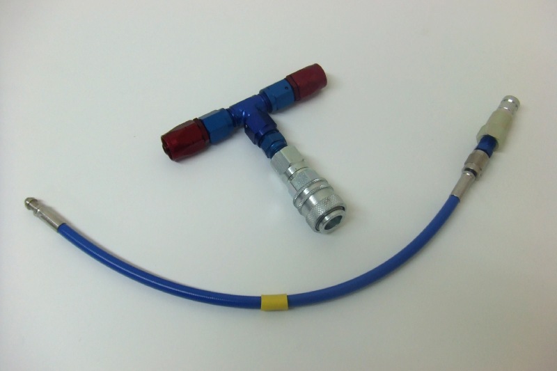

aiming to get this Fuel Sampling kit (from HEL)..... to meet with TA 'anti doping' reg's
