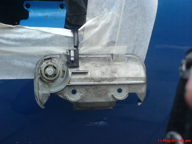

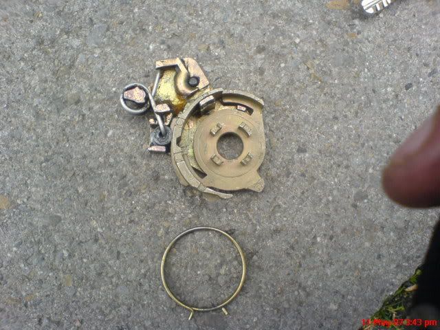

ok need some help here plz. been trying to put this lock back together but having some trouble.
have i put the lock back together correctly? and where does the big round spring at the bottom of the pic go?
Also in the which way does the mechanism (above pic) fit onto the handle?
thanks
[Edited on 11-05-2007 by Mo]
