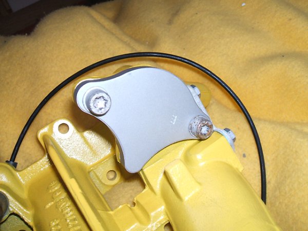

Superlite Ltd.
Registered: 9th Jan 07
3rd Oct 07 at 19:41   View User's Profile U2U Member Reply With Quote
Ah i get you.
Do this...
although your inlet won't be yellow

3rd Oct 07 at 19:44   View User's Profile U2U Member Reply With Quote
Originally posted by warren.g
its round the back of the engine and is abit of a c u n t to get too
everyone says its a bitch to get to (x16xe) but when i done mine, i had it out in about 15 minutes and didnt think much of it, wasnt a difficult task
was i just lucky?
mine was stuck due to shite building up on the opening bit and locking shut, i just got some valve grinding in paste and span it round the edge with a drill, put it back on and its never been a problem since.
so if your egr is stuck, you dont want to blank it, do that obviously clean it all up b4 you put it back on lol
