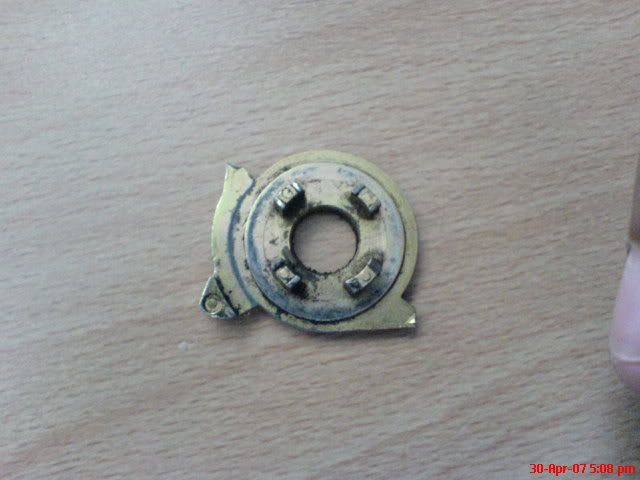

Had the lock apart and it seems to be the deadlock ring that is broken (top left in the picture on page 1) Does anyone have the part number ?

need some help plz. just been to vauxhall and they said i have to buy the whole mechanism. do all corsa have the same bit that breaks? ( big grey part in pic)

30th Apr 07 at 16:17   View User's Profile U2U Member Reply With Quote
the bit thats broken on mine (pic below) looks different to the grey one in the first pic ??

30th Apr 07 at 16:34   View User's Profile U2U Member Reply With Quote
Is not the wrong way up?

30th Apr 07 at 16:37   View User's Profile U2U Member Reply With Quote
oh yeah

1st May 07 at 13:20   View User's Profile U2U Member Reply With Quote
A bit fell out the bottom of the door today and it's definitely the top middle one (if you ignore the little black thing on the far right) that has broken, so Joe's diagnosis was spot on

i went to vuax again today but the guy still couldn't find the piece. I really need a part number for this piece now. Joe?

1st May 07 at 17:22   View User's Profile U2U Member Reply With Quote
Once the back of it is off the handle. On the first pic, the 2 big pieces in the top row need to come off. So no you don't need to go to that extent.

1st May 07 at 17:26   View User's Profile U2U Member Reply With Quote
Also Dean, you will need the tiny little roller which is on the top row on the right. This falls out when it breaks so could be anywhere.
