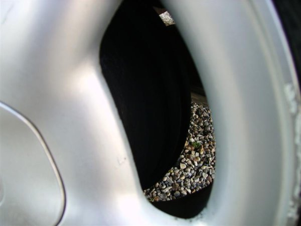

slight update from the other day.

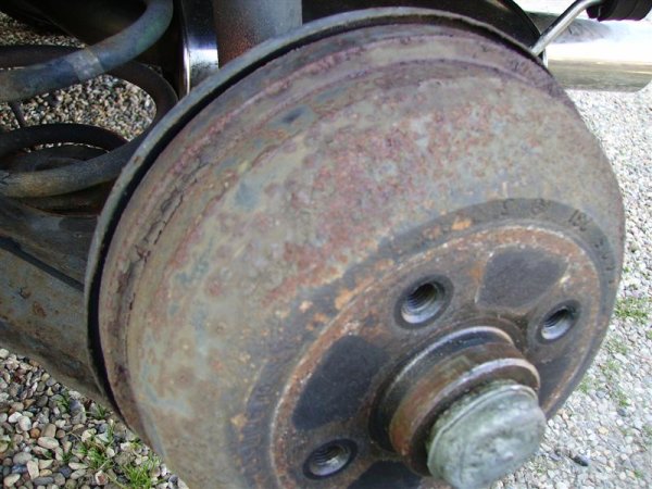

Did a genral check on the front and rear pads in the discs and drums to check they werent too worn. they were all ok but i dedided to tidy up the drums whilst i was there with some black hammerite paint
before
after

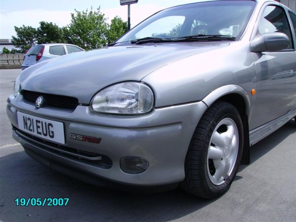

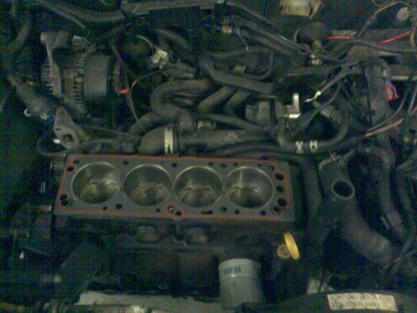

Right after many problems and a while off the road my car is back

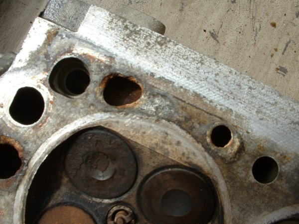

I noticed it was using lots of coolent and origionally thought it was the rad as I had noticed it had been damp under the car before. However it turned out to been the headgasket.
So the car was sent off to warren.g who did a top job at sorting it all out with all of the problems that he came accross. Once the head was off it was apparent that it was worse then first thought and that the head had been badly corroded by head gasket going
So i then set about tracking down a new cylinder head that proved harder then i thought. But i eventually got a nice ported and polished one from dave a for a good price
So then the car was all reassembled along with a new timing belt, rollers and water pump. Also relised i had been lucky in some ways as once the belt was off it was apparent how knackered the old one was
The car now runs sweet as a nut, many thanks to warren for all the work. If anyone needs anything doing and is in the south east I can highly recomend him drop him a u2u and seen what he can do

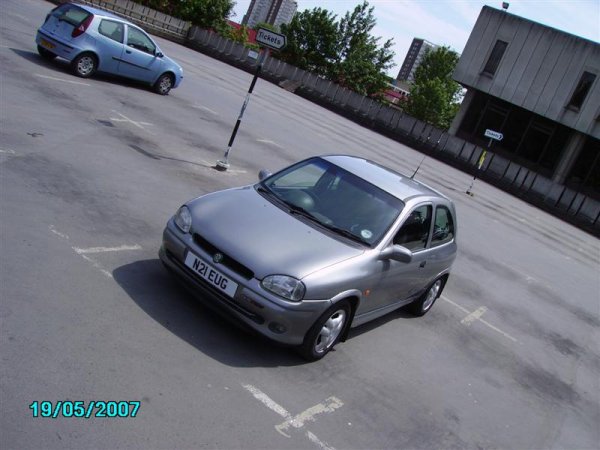

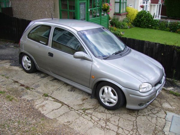

The car also had all of its plastics (bumpers, acrhes and skirts) resprayed and the rust taken off of the tail gate so it now looks good and goes good

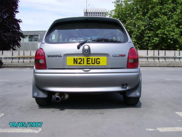

So it got a wash today and the compulsory pics were taken

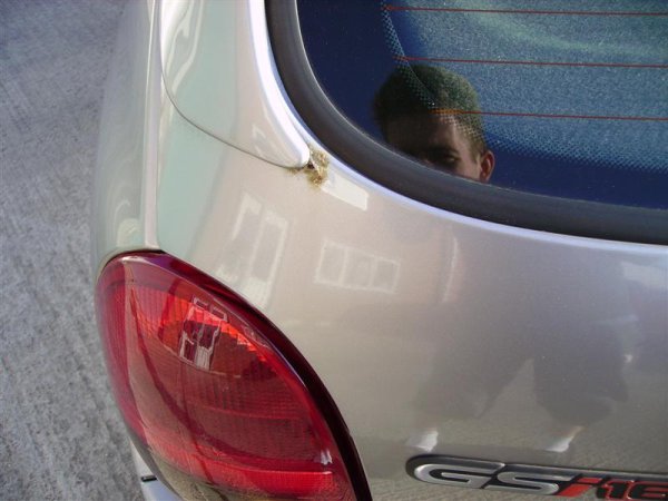

What did you have done to the boot lid to sort out the rust - respray??
20th May 07 at 20:04   View Garage View User's Profile U2U Member Reply With Quote
spoiler was removed and then the rust sanded back then resprayed and blended in.
The rust i had was on the end of the spoiler where it joins the boot here

has the rust come back? or is that a old ic gaz?
21st May 07 at 18:44   View Garage View User's Profile U2U Member Reply With Quote
Within a month i would hope not i would be straight back to the body shop for a word
No its an old pic from the day i got it

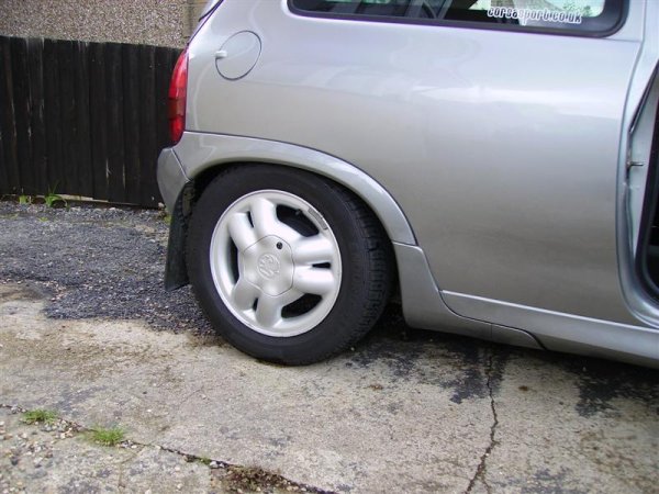

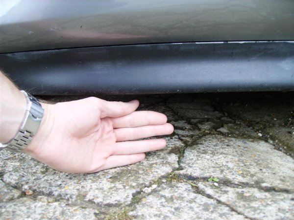

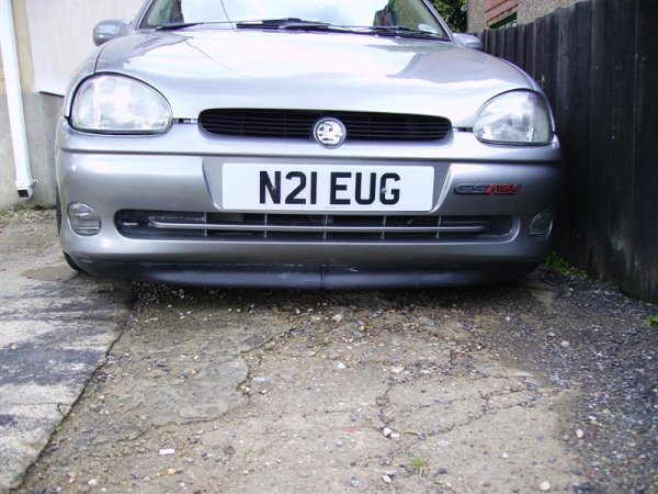

Right the car got its suspension fitted at the weekend
Got a G-max -60mm kit from Drax, thanks mate and went round to warren.g's to fit it.
All went on nice and easy with no set backs which was unusual for my car
Handling seems nicer now. Seems sharper and more predictable and the turn in seems better. So all in all im very happy with it. Just got to watch my bumper now

abit low? gona be hitting the speed bumps if you dont go over @1mph and look a knob.

5th Jul 07 at 19:58   View Garage View User's Profile U2U Member Reply With Quote
Only caught it once so far

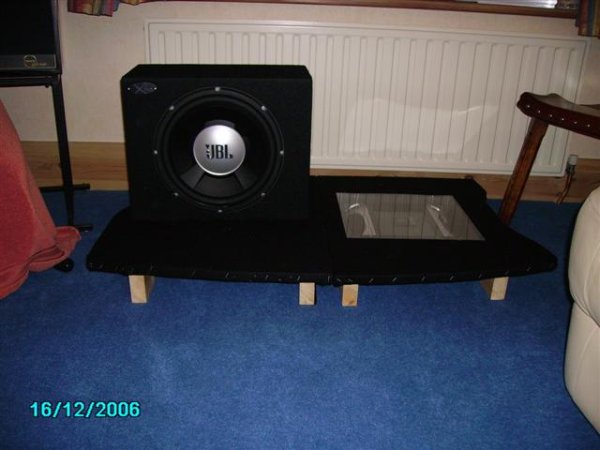

Right I spent this weekend fitting some new audio stuff to my car as i wanted to ditch all of the cd's littering the car and go to using my Ipod
Had a few issues with the wiring to get it to have a perminant live as i think the accesory position on my ignition is fecked but thats all sorted now
Quick faff around with the wiring to get a constant live (cheers richie and pow for the help )
New unit in and ready to go, sounds better then the old JVC one too which is nice
Considering upgrading my front comps to 17cm ones now too so the sound is nicer

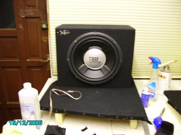

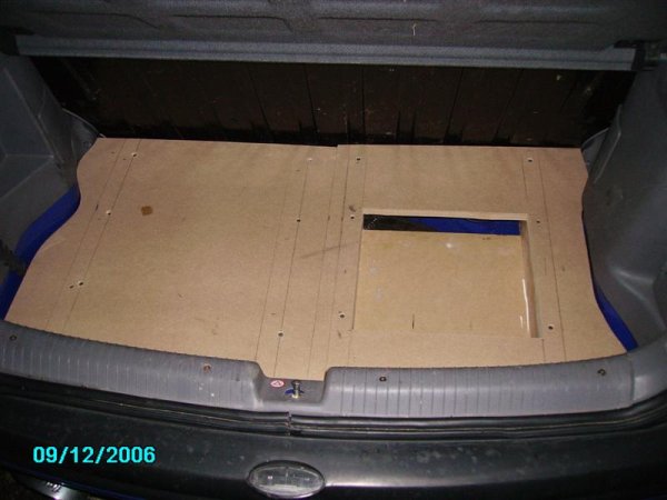

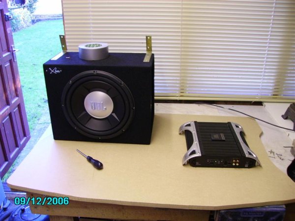

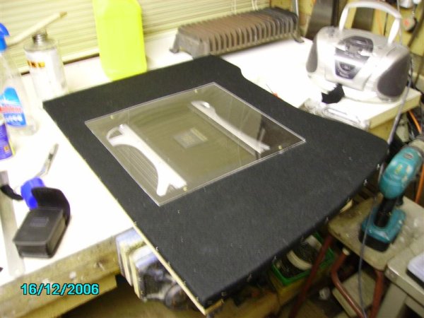

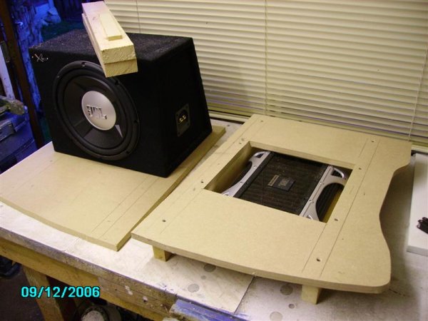

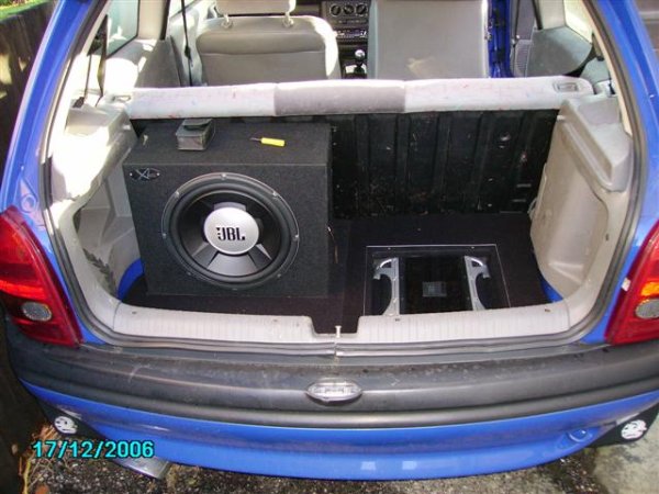

Also finally bothered to fit my sub and amp to the car that i had in my old one, Nothing special just knocked it up from some MDF to keep it tidy. Heres how i made it a while ago..........
Cut some cardboard templates to get the size and shape of the boot right
Cut the mdf to the shape and size and marked out where the sub and amp were going and cut it in two so that it is easily removable from the boot if needed.
I then cut the hole for the amp and made an enclosure and feet for the mdf to raise it up off the boot floor. I did the same for the other side
Trial fitted it to the car
Gave it a little sand down til the fitment was nice (made it a little bit loose to allow for the fabric covering.
Covered the mdf in felt using pva glue and stapling around the edges. The sub box was then bolted down

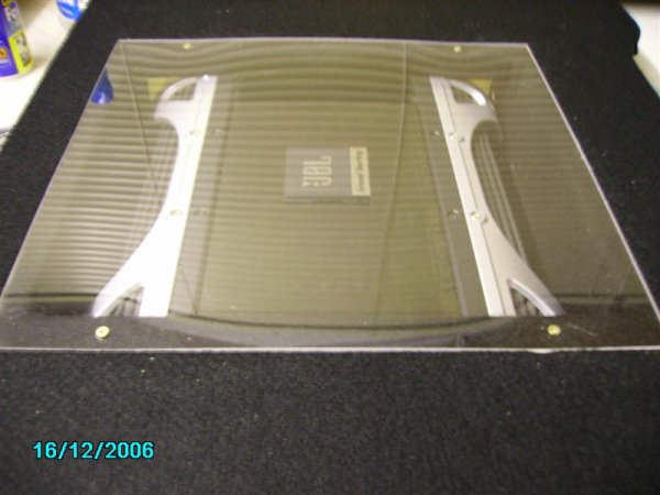

I then used a routor to make a lip on the mdf to sink the perspex into. once the fitment was good i fined this side with the felt and screwed down the perspex ontop.
finished and ready to fit
how it looked in the old car

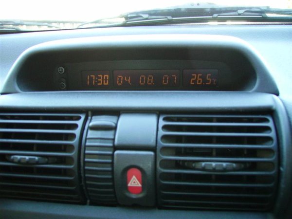

Next I went to the local vauxhall breakers and got a new MFD as im sick of looking at 0.00 01/03/1992 everytime i get in the car
Also got a new hazzard switch as mines a bit tempermental and i want to avoid trouble at mot time. Only downer is they didnt have any with the little led but this isnt too much of an issue
MFD with todays date on it

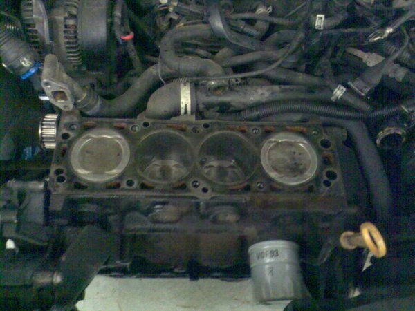

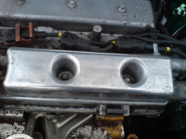

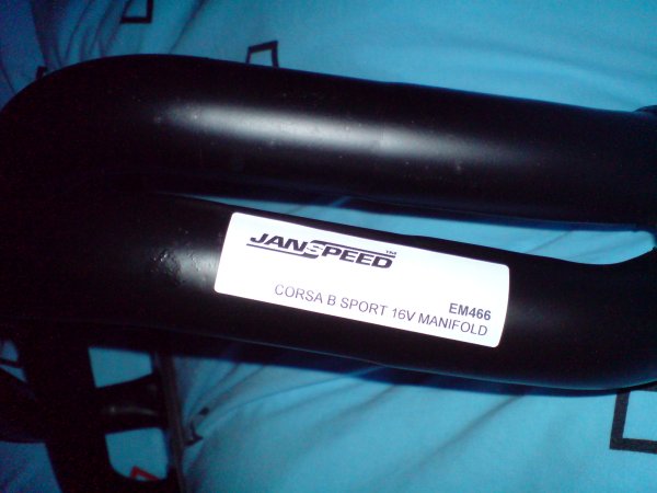

Decided to keep the corsa and get its smoking and oil drinking habit sorted along with a few new toys on the way
First off I began spending the £££'s and buying parts:
> bits needed to cure smoking problem and make engine run nice including, rings, stem seals, bottom end shells, headgasket, headbolts and so on.
>arp bolts
> sbd rollers
> mantzel inlet
>janspeed 421 manifold
This kept the postman busy and amused the cat
Then it was off to kent to leave the car at warren.g's dad's house to let the people who know what they are doing do the work.
Left it there for a week and went to collect it the week after
All went well except for me buying a set of rings off of someone and them been the wrong ones and cylinder 4 been corroded. But after honeing all was well again
Couple of pics I was sent

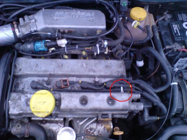

Now with the car back ive got a few things to finish off such as finding a suitable peice of air ducting to go from the air box to the inlet and genrally tidying up the bay. Car runs lovely but has an ECU light which is throwing up codes 43, 63 and 64 which are distributor/coil pack related. so we are going to look into this. We are suspecting it is an earthing issue.

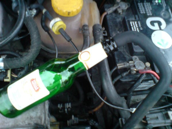

Doing to get myself a proper oil catch tank at some point but for the time been ive made one from a plastic beer bottle Mum thinks I have taken up drugs since she saw me melting holes in it
Then set about cleaning up the engine bay, but I got cold Check out how far i got
More to come shortly including the remap when im sure all the niggles are gone
Top to warren for all the work and his dad for letting my car clutter up his house yet again. Highly recomended to anyone in the SE area.

lots better now. The 421 and stuff has given it alot more lower end and mid range pickup. At 30mph in 4th you can put your foot down and it picks up really nicely compared to what it used too.
The mantzel makes a big difference once you hit 5krpm. Feels like you have put your foot down on the accelorator more
Just a shame that the limiter kicks in as soon as your getting into it Soon to be sorted though when i find somewhere to get it mapped
