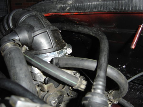

well beardy did it , and he said it works fine in loads of corsas, maybe i'm just being a girl with it sitting too close to the bulk head? what do you think from the pics?

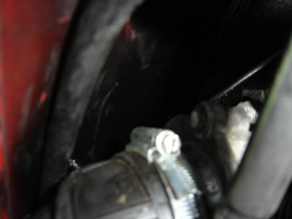

i aint out the ecotec pipe on yet but on page one can you see the top of the inlet manifold, thats where its touching, well its about 2-3 mm away from it, but the brake lines are behind there and dont wanna rub against them

Your engine looks to be in the right place, it is very tight because of the size of the inlet manifold, will go take a few pics of mine to compare as i'm still in pieces

what do you think about the new pics of the inlet manifold? too close??
4th Jul 05 at 22:02   View User's Profile U2U Member Reply With Quote
It's hard to tell, though it looks ok. The thing is though, it can only be in the right place with the way the mounts are positioned. You used the Corsa gearbox mount and a new engine mount, if the engine mount was not in right then the engine would not be in straight. They are really really tight fitting engines in a Corsa bay, my Ecotec pip is up hard against the bulkhead so much so it is squeezed inwards a bit, but I guess that is what you have to put up with if you want a big block engine in the car...
