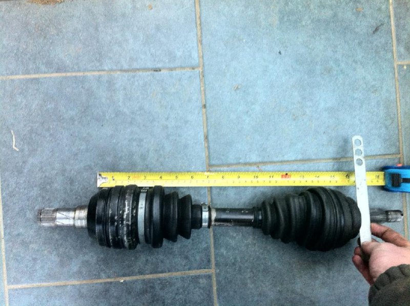

19th Feb 12 at 14:15   View Garage View User's Profile U2U Member Reply With Quote
Been asked to measure my driveshaft to double check the sizing with shafts other people are using (bigron)
heres the culprit:
End to End it measures 575mm
From mounting face gearbox end to mounting face hub end: 410mm
And here no damage or wear & tear, circlip is fitted
[Edited on 19-02-2012 by Danny W]

19th Feb 12 at 16:55   View Garage View User's Profile U2U Member Reply With Quote
Just speaking to Mike on migweb, soo confusing to try explain things over the phone & internet lol but hope this makes sense seems the likely explanation
Originally posted by mikesmith181with the inner joint fully stretched its 20.25 inches up to the abs ring which is in your second picture at 405 mm hope that helps you.
Originally posted by Danny W
thanks for the measurement mike, i measured from the mounting face of the joint (gearbox) upto the abs ring (hub) in the second picture to give me 405mm/16 inch
Like so http://www.corsasport.co.uk/carimages/9482/driveshaft_measurement_3.JPG .. this seems miles out aha
So I've just gone and re measured:
from the very end of the inputshaft? (gearbox) upto the abs ring (hub) : 19.25 inches or thereabouts
Is this the same way that you measured yours? if so that makes more sense to me & that the shaft is an inch short
Edit, Turns out above is correct, the shaft is an inch shorter.
will order a Corsa shaft this week, have it all back together and booked in for an MOT in 2 weeks time .. 3rd time lucky

3rd Mar 12 at 14:14   View Garage View User's Profile U2U Member Reply With Quote
UPDATE:
Last week my new shaft from LMF arrived, so built it up with the inner & outer CVs although i had to go buy a new outter cv due to braking the other one. Fitted it and took the car out, drove perfect and the shaft stays in the box Result
If anyone needs a nearside short conversion shaft for a nova they can have the one i took off
