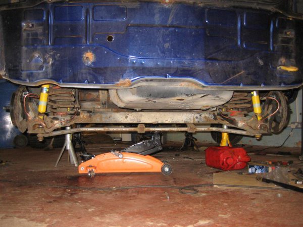

If we can sort new brake pipes than we'd be as well just cutting what's already on so we can get a six-point socket on the old unions, seems to be the only way no to round them so the pipes can be off next time I'm there, hopefully Tuesday then it's just making up new and swapping the cylinders so if we've got everything in stock or easily available then the back brakes and brake fluid should be done next time I'm there.

The rear brake lines on the beam aren't too hard to make if it came to making new ones, Would help when fitting braided lines too (If you are/do fit them?)

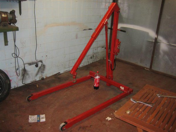

HAUL
XE Col
Registered: 23rd May 10
Location: Rochdale, AKA:Boissy07
15th Mar 11 at 21:44   View Garage View User's Profile U2U Member Reply With Quote
all that crane for a bottle of coke?
Bit extreme
15th Mar 11 at 21:45   View Garage View User's Profile U2U Member Reply With Quote
That's for scale, it's a beast. Just been and picked it up.

Originally posted by Ian
That's for scale,
Really? no way i hought you needed help lifting the bottle

Love it all! Where'd you get the hoist in the end mate? Vegga will be much easier this time
15th Mar 11 at 22:56   View Garage View User's Profile U2U Member Reply With Quote
Ebay special, collect from Warrington.

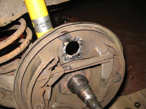

ARGH, give up for the night, Back brakes built back up, bled, shit pedal bled again, shit pedal give up with that then moved onto the exhaust, went to fit the cat, captive nuts on the downpipe knackered, widened them out so we could put a nut on the other side then could only find 1 suitable nut Went to fit the cat with the 1 nut and bolt and the bolt won't go through far enough to get the nut on so what's left of the captive nuts need drilling off completely so that there's enough thread showing to get a nut on the end.
Not the best of nights
