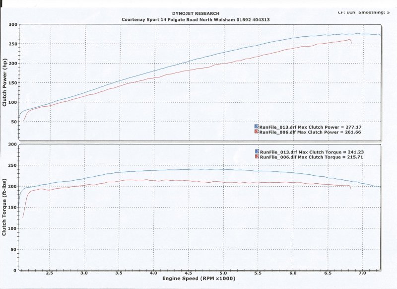

What sized pulley are you using?

it is fun to drive, real easy and good mpg
using a 3.1 zzp pulley at the moment.

Thats quite a good number for 3.1" pulley.
Have you uprated your rods yet?

not yet, that's why the boost Is low and theres a rev limiter on.
going to build a new bottom end with forged rods and pistons to keep it safe then turn the boost back up.
didn't think it would make anywhere near that power, neither did Courtenay's guy's

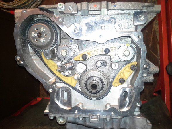

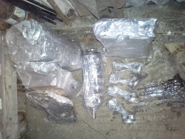

had a spare hour and half tonight so set too with stripping the brand new Saab engine,
[img][/img]
[img][/img]
[img][/img]
wrapped up the parts ready for rebuild as they are clean already to be fitted.

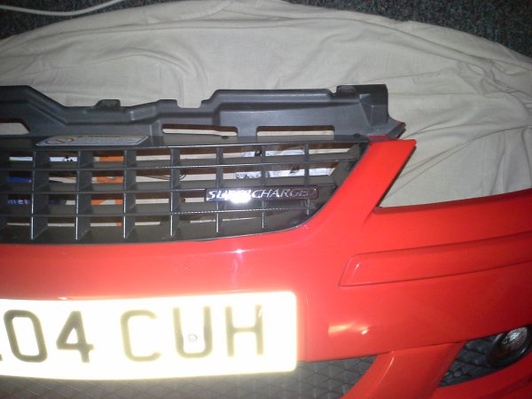

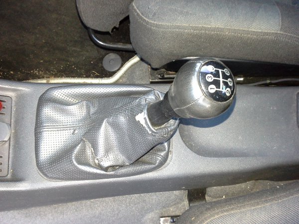

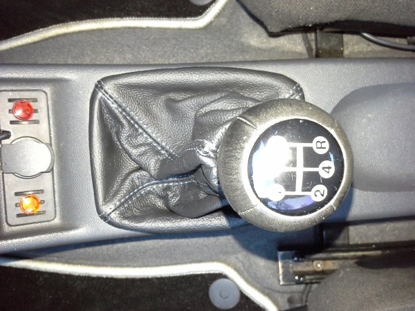

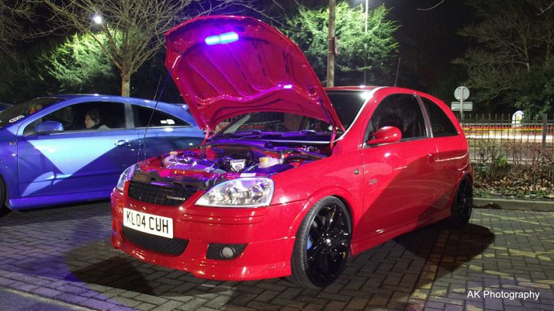

more jobs done today, new front splitter fitted, new headlamp bulbs fitted, blue leds under bonnet, seats, and over amps, new gear stick and hand brake gaiters fitted, new reverse lamp switch fitted, new badge on front grill and a few other little jobs.

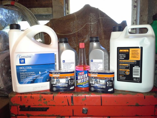

also collected new fluids for engine rebuild/fitting

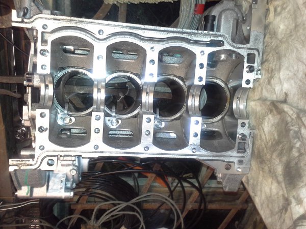

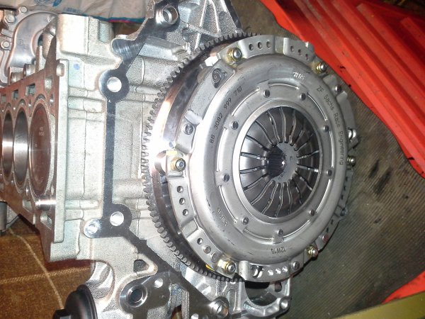

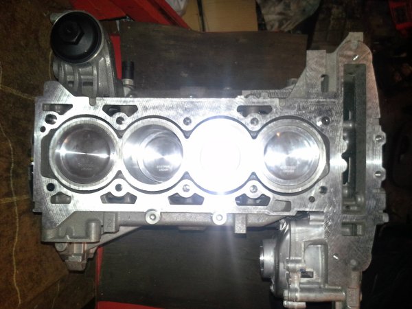

busy afternoon building up the new forged bottom end.
new Saab b207r block and sump, lightend/balanced crank, eagle rods, wiseco pistons 8.9:1cr, light weight flywheel, sachs organic clutch, balancer shaft delete.
[img][/img]
[img][/img]
[img][/img]
next is to rebuild the gearbox and fit the quaife diff.

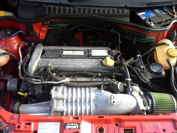

rebuilt new gearbox, now using 3.55:1 final drive and gear set from a 1.7dti corsa c F23 along with a quaffie diff. slowed it down a fair bit but still pulls great and at 2600rpm for 70mph she's great on fuel to (35mpg)
fitted new bottom end, oil cooler, new sound system, new gear shift shortener, smaller pulley on charger, bigger injectors had her mapped.
need to dial cams in for best results and get freer flowing exhaust system 3" manifold back as she's a bit choked at top end. but other than that she sounds great and puts a smile on my face

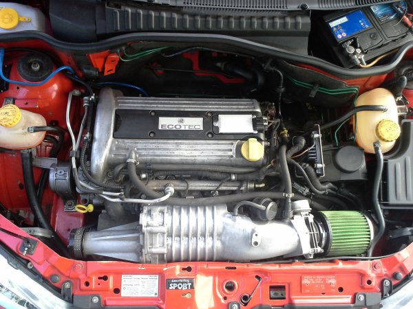

finally got around to finishing the engine loom off,
[img][/img]

first stage of the z22se supercharger only cost me £1500 with mapping that got me to 283bhp with stock bottom end so ran it restricted to around 260bhp until I built this forged bottom end.
so not as bad as you think if you do work yourself.
