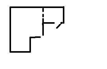

I would like to build a custom shed/summer house combo.
Will be a corner piece, with two longer sides which will be a shed, and then the corner piece big enough for eventually a hot tub. like this:
Where im stuck is, whats the best way to go about drawing up what i need to buy etc. I need to work out how much its gonna cost before i go ahead with it.
Any pointers?

Concrete base will be expensive.
I'd build it like you would an internal wall an a house out of 3x2" scant.
Couldn't advise on roof though as its an 'L' but 3x2 againc cover in ply and shed roof felting.
Would cover walls in some sort of rough sawn 6x1 etc
Gary
Registered: 22nd Nov 06
25th Jul 11 at 15:21   View Garage View User's Profile U2U Member Reply With Quote
Upright spacing would be 400mm or 600mm centres. I'd go for 600 as it's cheaper. 400 would be overkill for a shed.
That'll give you an idea on quantitis.
Stick some sizes on that drawing and I'll work out materials

Ok cheers gary.
The roof i was planning on making in three piece, Kinda a triangle section in the corner piece.
Dan
Registered: 22nd Apr 02
25th Jul 11 at 16:57   View Garage View User's Profile U2U Member Reply With Quote
If i give you a rough idea, the two back bits of the L will be 5m each. Maybe 4.5m if it works out alot cheaper due to wastage etc.
Ends will be 2.5m
Does that help? or you need more? Whats the best height?
Also, can you knock summit up for a 6.5m x 3m shed with 2 sets of double doors and 1 single along the front.

Draw out how you'll building it to scale on paper, that'll tell you what materials you need AND how you'll put it together.
Will help clarify in your mind how it'll work as you draw it.

I'll have a look tomorrow when I can be bothered and work out material needs etc.
However you build it the centres measurements I gave you are very important. Builders/joiners work buy those so ply sheets, plasterboard sheets etc are made to fit those.
Flat roof may be an option. Will be cheaper and easier. A hell of a lot easier.
You'll also need some sort of damp proofing under the outer Walls, to make it 100% waterproof.
Anyway, will fuigure something out tomorrow.
