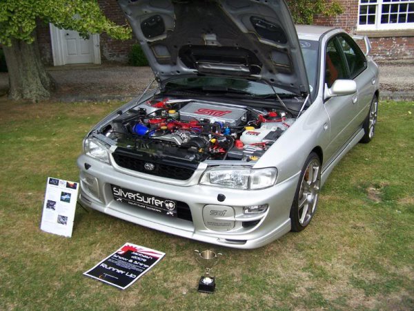

Purchased in March 2011.
Please see full Spec listed below along with some initial Pictures:
The previous Owner provided me x 2 A4 ring binders crammed full of EVERY invoice, MOT and Service Record since new! Car has only covered 55k Miles.
Had a long drive back which gave ample time for testing and wanted to see how it compared to my previous Imprezas (WRX V3, STI V4 and V8 STi). Overall it is a very well setup and balanced car, the VF28 spools up fairly early and there is not much lag at all. The car stops very well with the Newage Brembo's (front and rear) and the Prodrive Bilstein setup with the ARB provides excellent cornering and does not sacrifice much ride comfort at all. I know it sits a bit high in the pictures but it really is an excellent balanced Chassis although probably better for fast road rather then track (Not focused enough).
Performance
335BHP/315ftlb @ 1.4bar

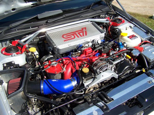

Engine Spec :
Hayward and Scott Decat Downpipe (Heat Wrapped)
Hayward and Scott Decat resonated Centre Section (Heat Wrapped)
TSL Group 'N' Rear silencer
Ported OE Header pipes
STi Version 8 Intercooler
Intercooler Air deflector
Interccooler WaterSpray (Manual and Auto)
Silicon Turbo Intake Pipe
SFS Silicon MAF Intake Pipe
Samco Turbo Hoses
Samco Boost/Vacum Hoses
Apexi Power Intake Induction Kit
VF28 Turbo (STi Version 5/6/P1)
Fuel Lab High Pressure Fuel Regulator
Custom Induction Kit Heatshield
Stainless Radiator Air Deflector
Spec-R Battery Clamp
Spec-R fuse Box Cover
Refurbished Red Inlet Manifold
Powder coated Header Tank
Powder coated misc brackets
Stainless Steel fittings
Engine Management :
Apexi PFC ECU and PFC Commander, Running 1.4bar 335BHP
Suspension :
New/Rare Prodrive Bilstein 40mm Inverted Shock Absorbers
Eibach Lowered Coil Springs
Front Strut Brace
Rear Strut Brace
Poly Bushed Front ARB
Poly Bushed Front Drop Links
Poly Bushed and Solid Rear Drop Links
Whiteline Adjustable Rear ARB
Wheels & Tyres :
Genuine Prodrive PFF7's 8 x 18 Bright Flitter Alloys
Toyo T1-R 225/35x18 Tyres (about 6mm Tread)

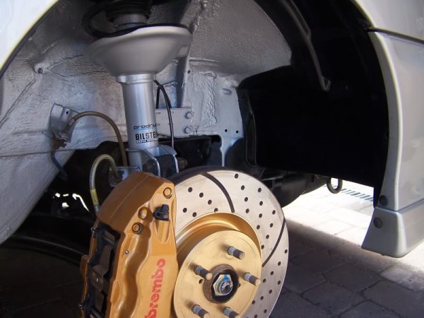

Brakes :
STi 8 Gold Brembo Front Calipers
EBC Grooved/Dimpled 325mm Front Disks
STi 8 Gold Rear Brembo's on custom mounts
EBC Grooved/Dimpled 297mm Rear Disks
Ferrodo DS2500 Pads Front/Rear
DOT Racing 5.1 Fluid
Goodridge Hoses Front/Rear
Brake Stopper/Support
Exterior Styling :
Prodrive WR Rear Spoiler
STi Version 6 Front Splitter
STi Version 5/6 Fog Covers
Colour Coded Skirts
Re-Undersealed and Painted Inner Wheel arches
STi Rear Lights
Clear Side Repeaters
Clear Front Indicators
Interior :
STi Version 5/6 Interior
Defi Style 3-Gauge Pod
Defi Electronic Boost, Oil Pressure and Oil Temp Gauges
Defi Gauge Controller (In Glovebox)
Autometer AFR Gauge in A-Pillar Gauge Pod
Richbrook Gear Gaiter surround

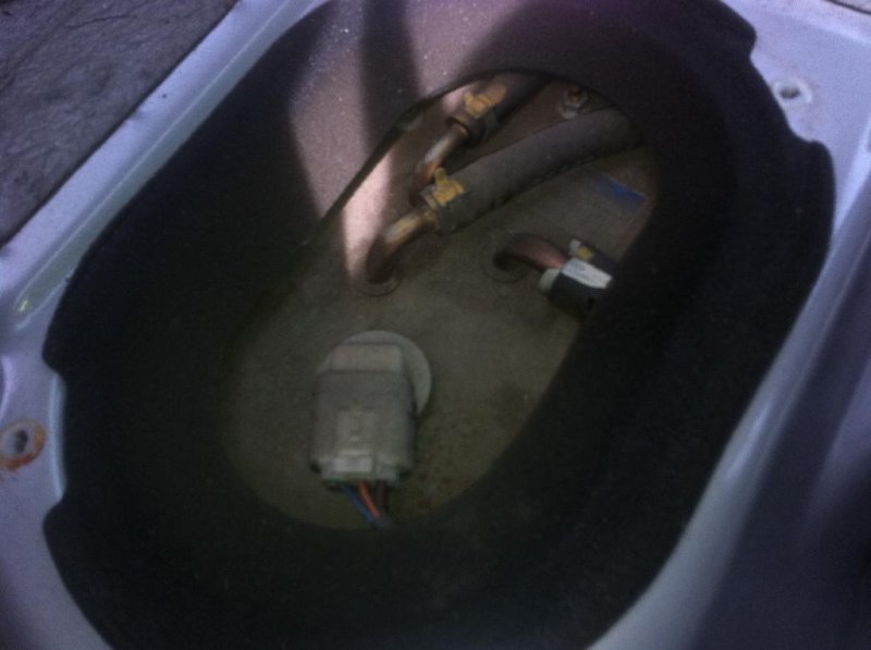

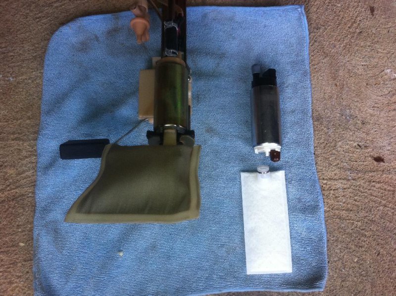

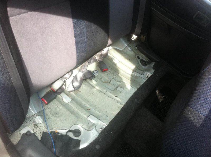

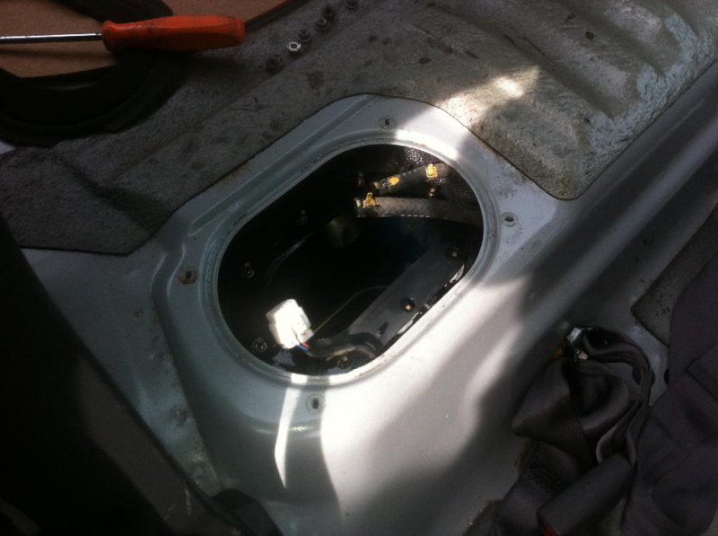

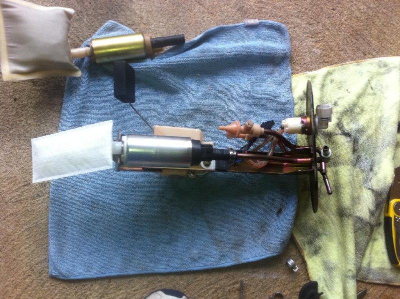

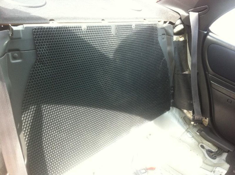

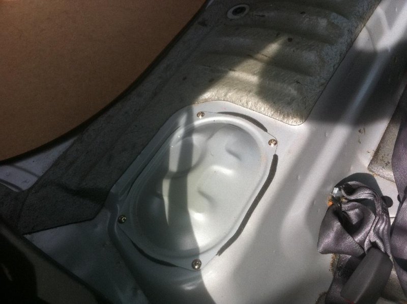

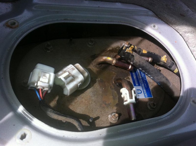

Replaced Standard Fuel Pump with Walbro 255lph
As mentioned before as a safety measure decided to replace the OEM fuel pump with a Walbro Item.
First of all had to remove rear seats. (bench in two parts)
This section literally just unclips
Exposing a metal cover over the fuel pump assembly
Removed metal cover revealing this :
Then removed Petrol Cap to relieve any pressure. Started car then disconnected the electrical feed to the pump assembly and ran car till it stalled (to remove any fuel that was in lines going to the assembly in an attempt to minimise leakage when removing them).
Rotated Pump assembly 180 degrees and pulled out from fuel tank leaving this swimming pool of fuel (maybe I should not have done this on a full tank)
Comparing old Pump with New :
New pump fitted into assembly :
Re-fitting was a reverse of the above procedure. No adjustments needed as fuel flow is controlled by a regulator in the engine bay. Think this was a good mod as a safety margin, the OEM one must have been pretty much at full flow.

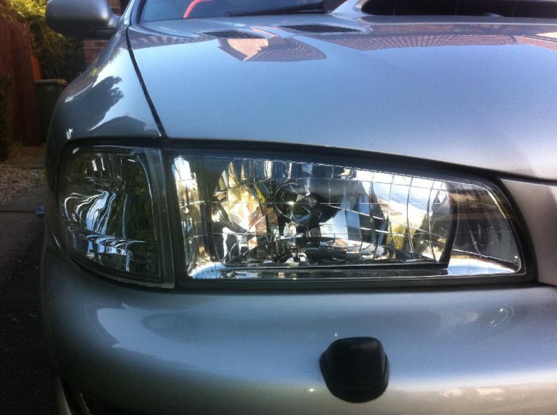

Fitted Crystal side lights to match headlights
Ugly OEM sidelight lens:
And after fitting Crystal Lens :
And job done! (Note car has headlight/sidelight protectors fitted also)

I debated this one in my head for a while. I kept the old bag when I fitted a Walbro to my STi V4.
I never drive around on fumes but I guess any chucking about on track with less then a 1/4 of tank may become an issue.
I may source a new OE bag, will only take 10 mins to fit it.
