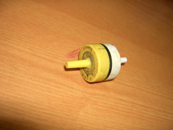

Author whats this? *pic*
Dave A
Registered: 10th Dec 03
29th Apr 05 at 18:04   View User's Profile U2U Member Reply With Quote
i thought it was a onw way valve, but allows vaccum to pass through both ways. unless its broke
where does it go
x16xe btw
James R
Registered: 4th Feb 03
Location: 205GTi16/306GTi16
29th Apr 05 at 18:05   View User's Profile U2U Member Reply With Quote
It's a 1 way valve that's broke

same as this then:
whats the thing it goes to called? ive removed my secondary air pump, thik it had something to do with that.
PaulW
Registered: 26th Jan 03
29th Apr 05 at 18:41   View User's Profile U2U Member Reply With Quote
non-return valve from inlet manifold to actuator for secondary air pump...
Used for the vacuum shitty job for opening the valve on the exhaust manifold for the secondary air pump to do its shitty job...
aslong as you dont remove the vacuum line from the inlet manifold to the actuator (next to the bonnet alarm sensor thingy) & block the vacuum hose off AFTER this bit, you can remove the pump & all the bits without the ECU throwing a hissy fit...
