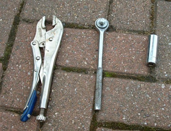

14th Oct 03 at 14:51   View User's Profile U2U Member Reply With Quote
all righty then,
for todays game u will need -
clamp it under the wheelarch here, get someone to hold it if need be -
then just tighten the top bolt with ur deep socket, 16 or 17mm it is -
