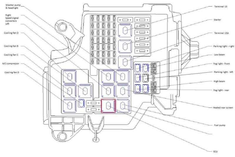

Ok so I'm refitting a 1000cc Twinport into a Corsa C 2005. It's in, wired up and plumbed in, it's turning but isn't fueling, sparking, no PAS and isn't reading on my code reader. It's like the ECU isn't getting power but everything is plugged in and the main fuses in the fuse box (in front of the PS strut) are all grand, both battery terminals are good and both have the extra cables wired in nearly. Any suggestions?

have you checked the relays in the main fuse box?

[img]http://[/img]

That I did not but it'd make sense though, cheers Dave.
