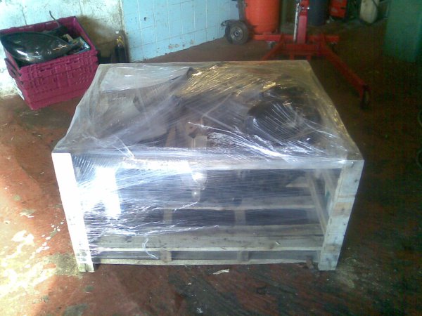

1st Feb 13 at 17:22   View Garage View User's Profile U2U Member Reply With Quote
I use Palletways - you can find a depot on their web site
http://www.palletways.com/
Contact the local depot, they'll come out and tail lift it on and its on its way. Costs about £55 so long as you're not going too far away up to the top of Scotland or outlying parts.
Needs to be securely fastened down and drained.
Could lay it down but depends what ancillaries are in the way and what you'll squash by doing that.
I stand them on the sump as the Puma ones are flat, not sure about the LETs, if not peftectly so you can prop it up and whatever you tie it down with should hold it in place.
I have a banding machine now so its no hassle, otherwise you might end up giving away a strap.
The other alternative is find a rock pallet, on those you don't need straps because you can bodge in bits of wood to hold it in place -
I also wrap mine which secures it a bit more, plus I normally enclose other boxes with other bits in so they need holding on without being strapped as that would crush the box.
