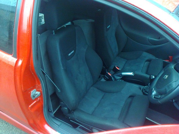

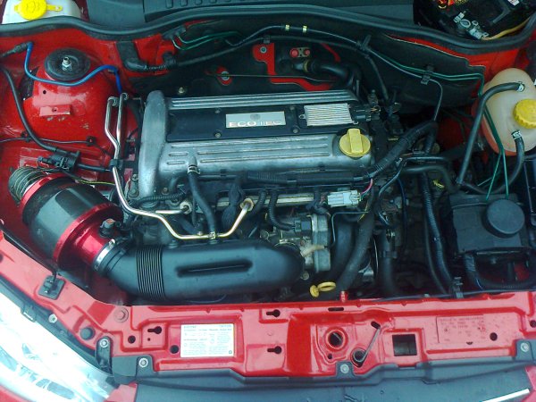

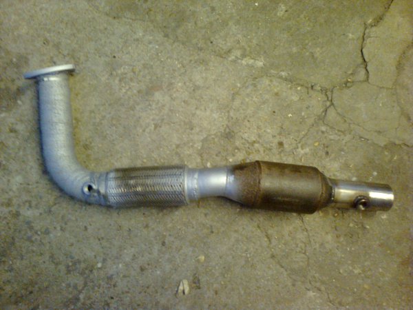

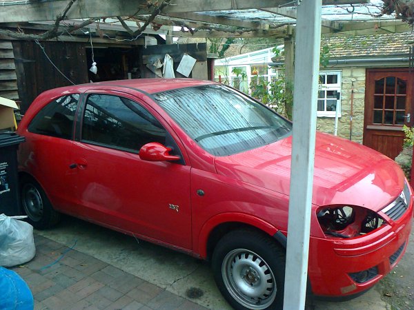

started building this car up in january. swaped the body minus engine, gearbox, lights and a few trim parts for a triumph heraled that needed major restoration. fitted Z22se engine and gear box from a vectra b had to make up a down pipe and cat to fit. using the vectras front brakes, 308mm with meriva vxr carriers, rear brakes standard corsa sri discs. vectra also donated its recaro front seats. engine was tuned in the vectra to 170bhp with shrick cams mild head work and full exhaust system. lots more planed over the nxt couple of years!

yes, speedo is playing around and the oil pressure light isnt done through the ecu on the vectra b so ive fitted a tempoary light untill i sort that. the triggers for the fan and fuel pump relays were diferant on the corsa to the vectra, live switch on earth but that wasnt hard to figure out. hardest part was fitting up the vectras throttle pedal as its a stepper motor type not a wiper type as found on corsas and astras. but if using an astras ecu i think it would be simpler? it took me about 20-25 hours to put the engine in and get it running, had to make the down pipe, rad brackets, move the engine mount on the front drill and tap holes in bell housing for the mounts as the lugs are there but not used on a vectra b. ive never done a z20let in to a corsa c, but this was just as easy as fitting the x20xev into the corsa b.
