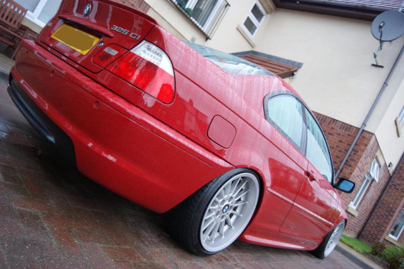

After deciding to hang onto my 330 until at least Spring next year decided to spend a bit on her.
I have been having a real dilemma with wheels and was looking at all the common options BBS CH, CSL and even flirted with MV3's and MV4's but could not decide.
Then I spotted this on bimmer forums :
Sitting on style 32's from an E38 7 Series
The offsets are mega low ET20 and ET23 so they stick out quite far.
Also 9" on the rear and due to the offset you cannot run more then a 215 Tyre hence the stretch. The owner of the car above had to have an arch roll on the back as well.
I have always modified my cars with performance and handling being the priority.
Have never modified for looks, bling, SCENE or whatever so going to give this a shot.
After watching these wheels on ebay and seeing them sell for between 500-700 a set i found a full set for £120 from a guy that had them as spares for his 7 series which he just sold. Did not hang about and snapped them up.
Just ordered some coilovers as well and found a place that will roll both rear arches for £70 and their work looks spot on.
So can pull this look of for not mega bucks and i LOVE those wheels.
A new direction for me

dunno what your on about 'scene' but that looks nice. not OTT or cheap

£120 is an absolute bargain

Not scene to the point that you're compromising too much.
If the tyres are nearly falling off and you ruin the car with hard suspension then perhaps, but that one in the pics isn't too daft.

touch too low on the rear for be but im picky
SetH
Registered: 15th Jul 01
14th Jun 12 at 17:36   View User's Profile U2U Member Reply With Quote
Yeah it will certainly have its challenges especially as mine is an auto and the sump sits lower (hence why Eibach only list the pro kit springs and not sportline springs for auto's).
Think there are a couple of car parks I will need to stay out of and will have to be careful with parking close to kerbs and certainly no bumping up them.
Getting aftermarket wheels to look good on an non M E46 is a challenge and i think the above looks awesome and not to far of OEM.

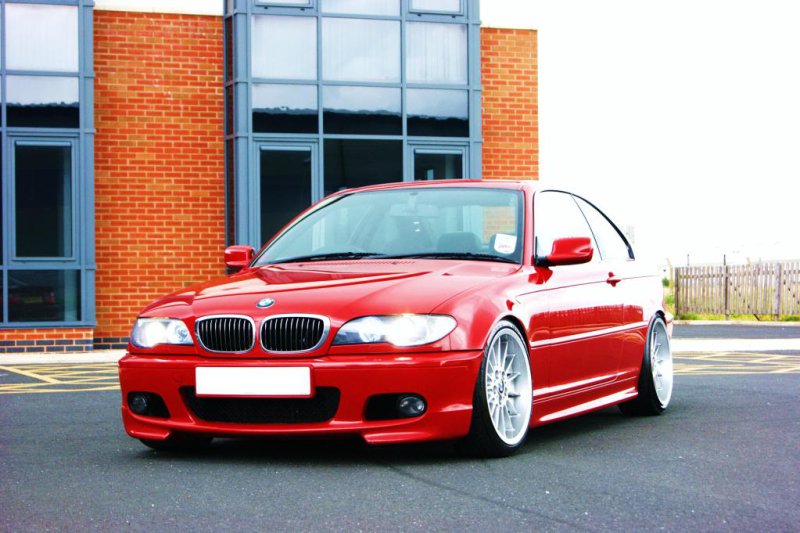

Mate Jamie has this set up on his 330ci and it looks awesome mate!! Mega choice
14th Jun 12 at 17:39   View Garage View User's Profile U2U Member Reply With Quote
That style is E46 as well is it not?
Not that wide I know, but they're still standing looking while fitting a bit nicer.

You can get an E46 version of style 32's but they don't have the deep lip and look a bit cack.

personally I wouldn't run such a skinny tyre on the back of a rwd car, is there no way you can squeeze something bigger on? I run a 235 on a 9j wheel on my car and its still got quite a bit of stretch to it.
That red one does look good though. Don't usually like those alpina style wheels but they look ace with the decent dish on there.
