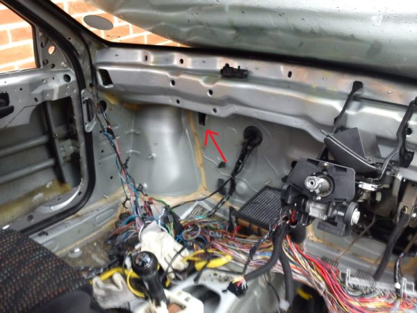

have a look at my project thread ive removed the ac stuff behind that , can will be able to see the hole it leaves behind

14th Nov 11 at 10:15   View User's Profile U2U Member Reply With Quote

What have you done

14th Nov 11 at 10:18   View User's Profile U2U Member Reply With Quote
haha thats geordies. which hole am i looking at?
Gary
Registered: 22nd Nov 06
14th Nov 11 at 10:23   View Garage View User's Profile U2U Member Reply With Quote
That at a guess. Nothing else there
Jed D
Registered: 15th Mar 11
Location: Durham
14th Nov 11 at 10:27   View User's Profile U2U Member Reply With Quote
thought so

building a rally car gary lol, was playing with the wiring harness

Its not that hole that is the issue, There is two holes in the top of that area which are about 20cm square.
I thought I had a pic but I can't find.

The one in the second picture is where the pipes are plumbed in, there is a big square hole where the cabin filter is.
That will need to go too because there is then nothing to bolt that too once the ac unit has gone.

Basic jist is, Remove the big box, Block the two holes in the scuttle, Block that hole in the above pic, Plus a smaller hole or two further down. Then to do the job properly you need to fit a pollen filter holder from a non-aircon model, this also stops water getting into the matrix/heater blower.
I think thats it, Been a long time since I did mine.

Whats the filter like thing on the floor in those pics?

pollen filter mate

its the heater matrix, its been removed now, and a bit of water pipe put in its place to join the 2 pipes back together

Thats behind the scuttle mate
