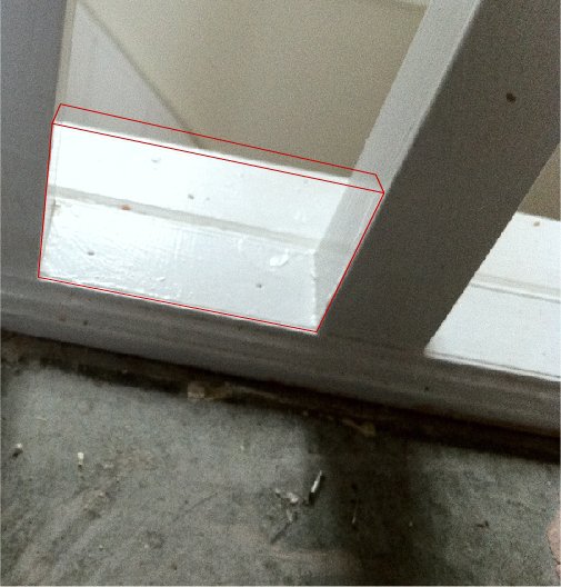

Just in the middle of ripping the carpet out of the bedroom and I'm already questioning my abilities to lay this laminate flooring..
How would you guys go about fitting the laminate up to this banister rail? The level of the laminate flooring will undoubtedly come above the level of the beading round the edge of the rail.

Looks about an inch to me

You cant cut it tight, as Rich said, it will swell.
Could box in the gaps to raise the base level, like this but on both sides and top...
Gary
Registered: 22nd Nov 06
17th Aug 11 at 15:54   View Garage View User's Profile U2U Member Reply With Quote
Or cut some 18mm MDF pieces to fit in like this....
Could double them up to give you plenty of height. Bit of gloss and youd never know.

Can't tell with this monitor or pic the finish on the banister moulding but you may get away with a flat beading stuck to the bottom rail. Still leave your expansion gap etc...

Chances of removing the balustrade without ruining it are nil, the spindles sit in a groove in the bottom rail and handrail with infills inbetween, you can make out in the pic where they have been pinned in.
The neatest option would be to cut it tight into the bottom rail and put a small bead of sealant on, either white or a colour similar to the flooring., Realistically any timber beading is going to come up over the mould on the bottom rail and leave an unsightly finish unless you have enough room to put something very thin and flat on. If you do cut it in tight remember to leave as big a gap as possible on the opposite side, basic laminate doesn't move much but best not to take the chance.

i would do what gary has suggested, and run a bit of chaulk round all the mdf bits and paint it and then slap some beading down to cover up the expansion gap

Don't do any of the above.
Get yourself a matching coloured laminate t bar and cut/plain the back of the bar so that it's flat then stick or pin the bar direct the the laminate.
Depending what flooring your using and door bar and trims are available you can always use an end profile which is a 90 degree thin strip that will just slot down the gap you've left up against the bannister and cover your cut edge
Both of these bars can be stuck with mitre fix for instant fix or silicone with some tape to hold it in place until it's set.
