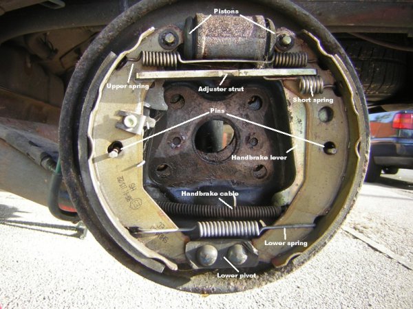

Sure? i thought the only thing holding the drum to the backing carrier was the stub axle which gets bolted through the drum carrier to the rear beam
10th May 10 at 10:36   View Garage View User's Profile U2U Member Reply With Quote
if you undo the stub axle bolts and pull it away are you not left with this?

I'd be worried if I was left with a blue rectangle that says "Image is remotely linked or blocked by firewall. fiestaturbo.com".
10th May 10 at 10:39   View Garage View User's Profile U2U Member Reply With Quote
thats a problem at your end then, not with my link

heres the pic for people that cant see it
