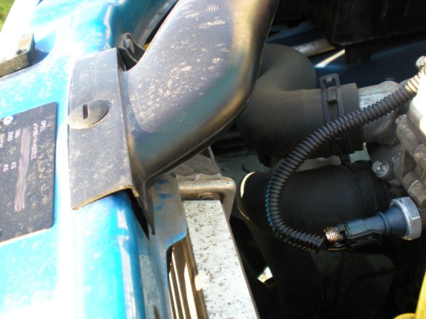

Is it the black plug to the left of the dipstick on this pic?
Oil pressure switch if it is - only a few quid from vauxhall and a 30 second job to replace - think its a 10mm spanner needed
More like a 21mm

It is indeed a quick job, but a 21 or 22mm spanner, something like that. Touch the bottom of it, if there is oil there then that's what the problem is.
Another pic:
It looks shiny there because that was a few days after I fitted it.

it was the oil pressure sensor and it was a size 21mm socket cheers lads
