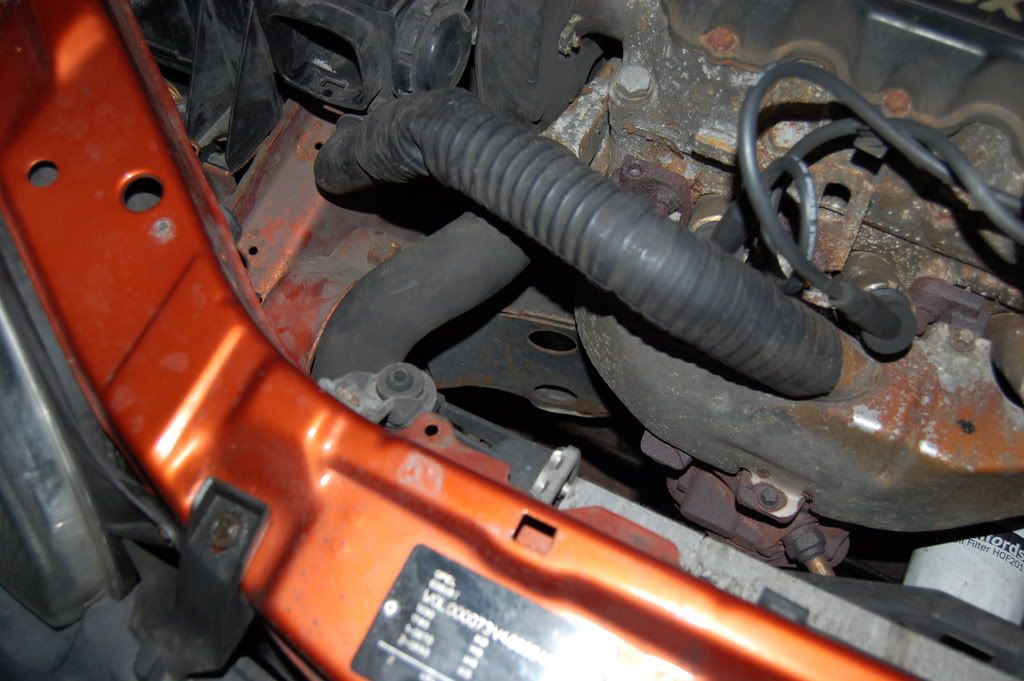

its leaking from
i dunno what its called
but if ure looking at a cors b 1.2 8v engine
below and to the left of the airbox theres that strut type thing with the 2 holes in it
think its a engine mount :S

post a pic of where it's leaking from
More likley a split pipe than a head gasket

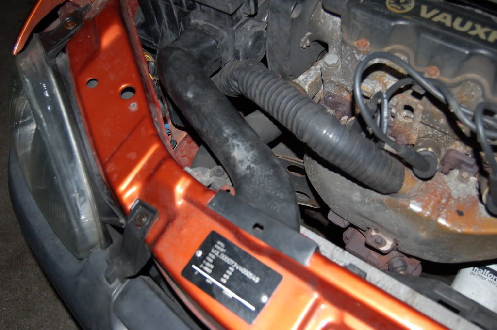

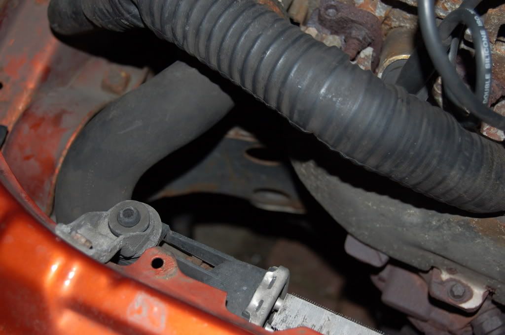

Pictures:
By the 2 holes apparently

Yet it's dripping from just below them 2 holes on the strut thingy

First off... Get some new mates, as they blatantly don't know shit about cars... Going from what you have been saying, if you listen to them, you're better off walking with 2 broken legs, as it will be more reliable than anything they try to maintain/fix with that intelligence level...
Secondly... Thats the top hose for the Radiator. I've had a couple of those blow, easiest way is just replace that hose from radiator to thermostat outlet.
Reason your saying its more apparent when hot is the thermostat opens at a set temp, so that can sometimes cause the hose to only show its weakness at that point. My Omega did this the past few days, was fine till it got to the temp for the stat to open, then there was a whiff of steam from the front of the hose where it attaches to the radiator. Only briefly though to begin with (literally about 10 seconds of lovely steam then it would stop and behave) till it went kaboom
And *never* undo the cap to the coolant bottle when your engine has just been run and is hot, no bloody wonder it pissed itself out!
Get that hose replaced, and also just give the radiator a visual inspection next time its run. Just leave the engine running for it to warm up with the bonnet open, you will soon see where/if there are any more leaks.
