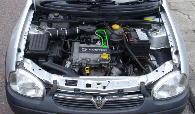

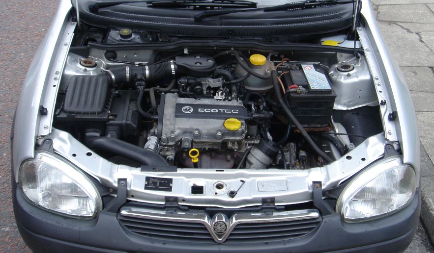

You get crank case vacum, and if there is a leak more air gets in to the engine via the rocker and makes the engine idle rough.
http://www.salvagedealers.com/LANCS%20WEBSITE%20IMAGES/VAUXHALL%20CORSA%201.0%20'W'%20009%20WP.jpg
See near the throttle cable to the right there is a pipe going to the top of the throttle body, thats the crank case breather pipe.
23rd Sep 08 at 19:42   View User's Profile U2U Member Reply With Quote
The bit that goes from beside the 3 bolts in the round plastic thing to the rocker cover?
The bit circled in green?
And how do you know if it's leaking etc?

Jahunt - is the bit I've circled the bit you were on about?
Joe
Registered: 20th Jun 04
24th Sep 08 at 17:38   View User's Profile U2U Member Reply With Quote
You don't calibrate a new one to the ECU, just fit it and start the car.
James_H
Registered: 16th Sep 07
Location: Slough, Berkshire
24th Sep 08 at 17:44   View User's Profile U2U Member Reply With Quote
yeh thats it!
See if that has any holes in it, if it doesnt, must be the icv, what does it do?
