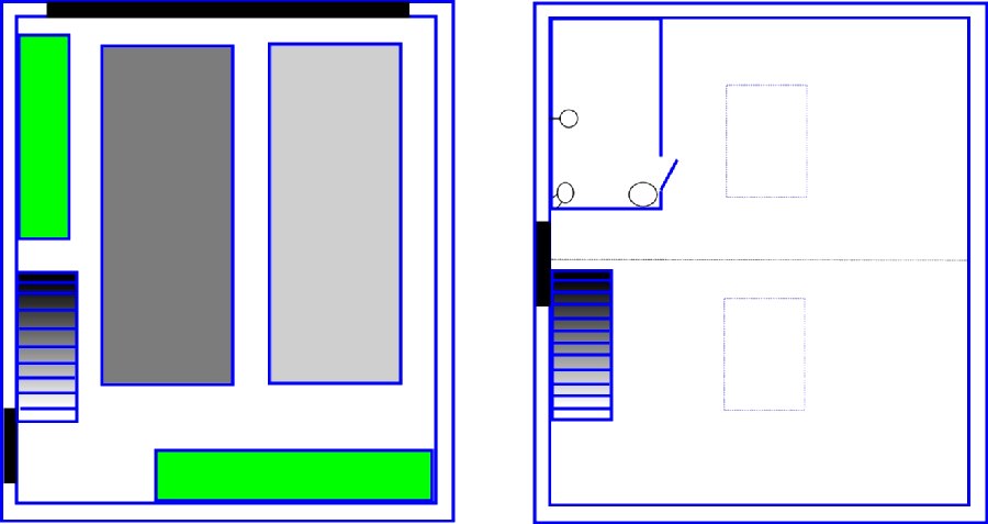

this is roughly what we're after... not as grand as some, but generally

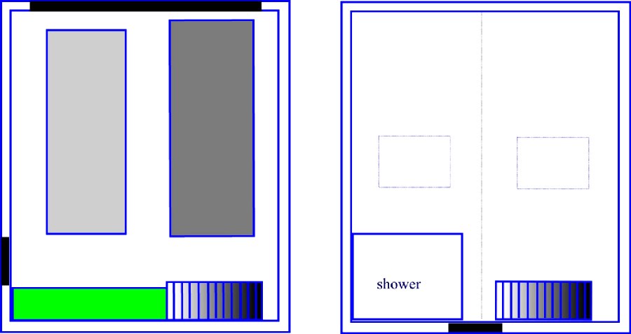

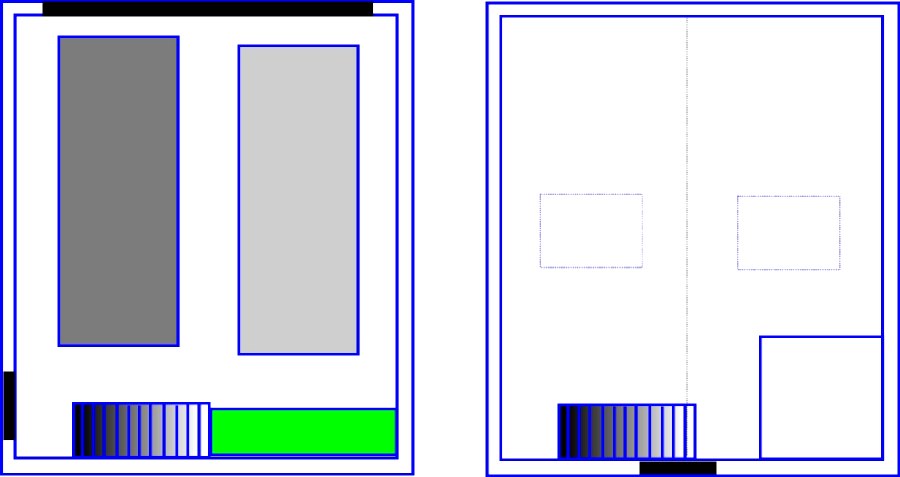

and some initial doodles to get an idea of space etc...
garage on left, upstairs on right
3 diff versions... peak of roof going different way etc. Two big rectangles are cars, green thing is cabinets
looking to have about 2m - 2.2m roof heaight for garage, then a decent roof height, with low angled peak to maximise roof/room space for floor above. Velux's, not dormers

i know someone who has just built a garage and it cost £13k for a single garage in brick and block with slate roof.
Even if you say £10,000 for design fees, at £50 an hour thats 200hours, no one would spend that long on a garage

7m by 6m roughly

bit of quick advice on design from a friend
the problem with living area upstairs is your limited on head room, without having a massivly high roof its hard to make things work. you can add dormer windows as seen in one of your photo above. Roof height and dormers will be the main planning issues i would of thought.
also your stairs need to land within your 2m head room, so usually centre of garage upstairs
alot will depend on planning issues really as to what you want to design
