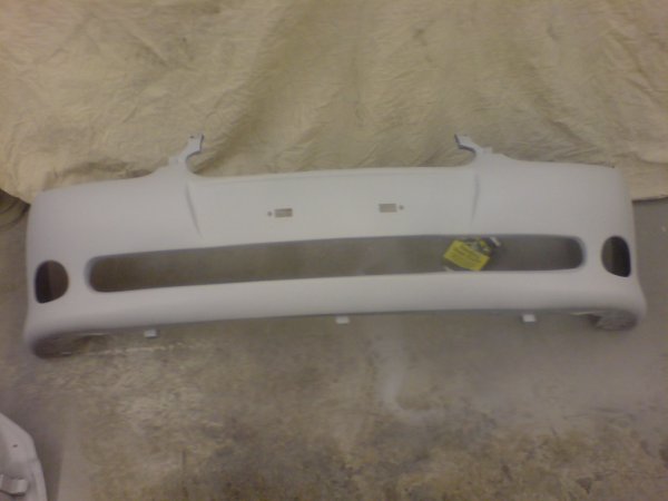

hello ther trying to smooth the above but need some insriration as it keeps going wrong and can still see the out line of the groove thanks dave

more filer?

keep putting more and more on but how do i know where to stop sanding and how do i get the shape any help welcome cheers

did you sand the bottom part down to plastic before puting filler on?

yea the whole bumper has been sanded down

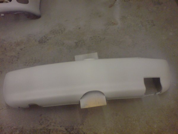

i spent ages doing a back one. put filler on from the top to about haf way down the bumper and sat there sanding it for days. helps to ge the shape doing it with sandpaper on a piece of wood about 8 inch long. helped me get it a more even shape
andyc1234
Registered: 7th Nov 06
24th May 08 at 17:38   View User's Profile U2U Member Reply With Quote
i did rear and gsi front for my mate

that looks good andy nice job

just put more filler on than you think you need you can always sand it back its better than keep adding bits
