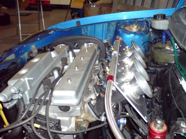

not an up to date pic but:
196 bhp @ 8600 rpm
135 ft/lb
1640cc
wossener forged pistons
Steel conrods
lightened and balanced crank and flywheel
standard oil and waterpump
jenvey twin tb's (45mm)
90mm trumpets
ITG sausage filter
Vsport 30 degree inlet
c20xe blue injectors
extensive headwork
Ivey 1 piece stainless valves
Solid lifters
double valve springs
Vsport spring platforms
O.E forged upper spring retainers
Custom cams (12.5mm lift 290 degree inlet 12mm lift 280 degree exhaust)
Kent vernier cam pulleys
SBD cambelt rollers
Fixed tensioner (cambelt tensioned by waterpump)
SBD alternator
ARP conrod bolts
ARP head studs
Cometic head gasket
Vsport high spec 4-2-1 manifold
Vsport 2.5" twin box exhaust system
Omex 600 ecu and loom

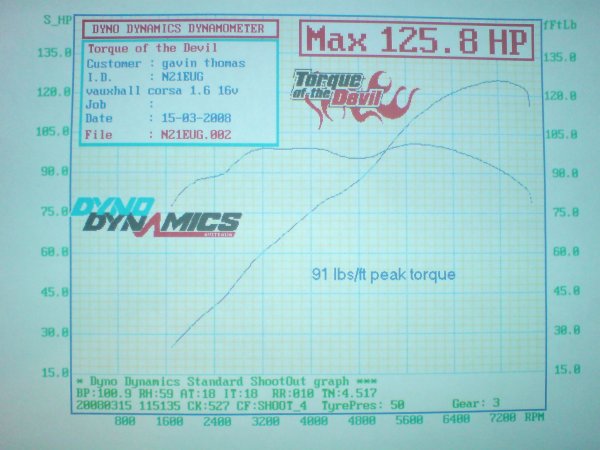

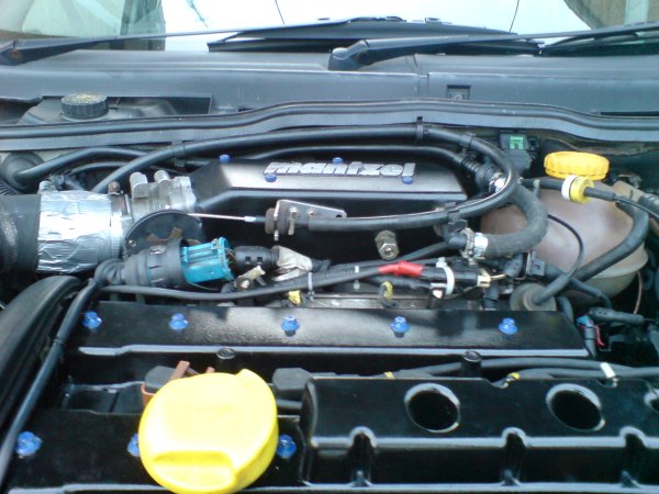

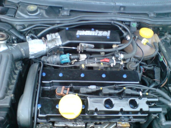

5th May 08 at 11:40   View Garage View User's Profile U2U Member Reply With Quote
Dave stop showing off
Mine
Drilled and modified air box with k&N pannel filter
mantzel inlet
janspeed 421 manifold
arp rod bolts
sbd metal cambelt rollers
Diablis ecu with raised rev limit
Ported and polished cyclinder head
magnex exhaust
Before the exhaust and modified airbox were fitted
5th May 08 at 11:42   View Garage View User's Profile U2U Member Reply With Quote
Noticed that mine lacks torque compared it vaux lads, any idea why?
