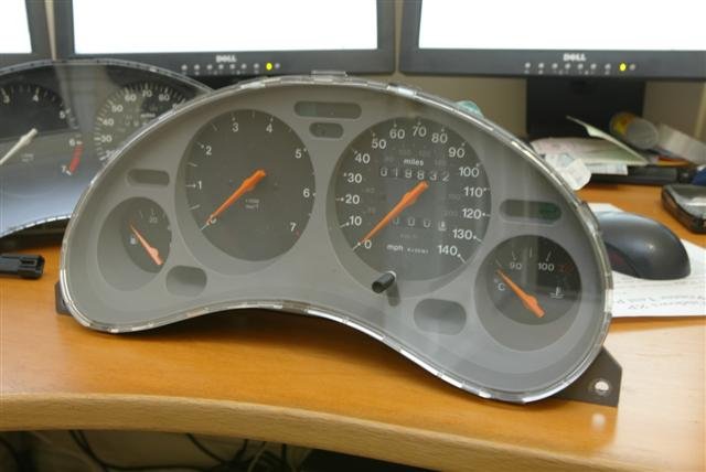

My aunty has a 1.4 tigra with the 140mph clock with orange needles etc. If i was to get a set of these from the scrap yard etc would these work fine in my 1.4 corsa?
Just wondering as one is 130mph and other 140mph

i replaced my dials in my 1.2 16v, got them from a scrappy, i belive that the k number just has to match on both sets. On the speedo in the center there is k = ? if the numbers match i think they should work, when i replaced mine they also asked the colour of the circuit board.

The clock surround is different, its not just the needle colour.
These are cable so starting at 10 - yours are 0 - 130 I think?
These are the Tigra / 1600 Corsa Sport fitment.

Well i knew about the surround being different. I just prefer the look of them to sport ones.
If i was to get some off a 1.6 would there be any issues?
