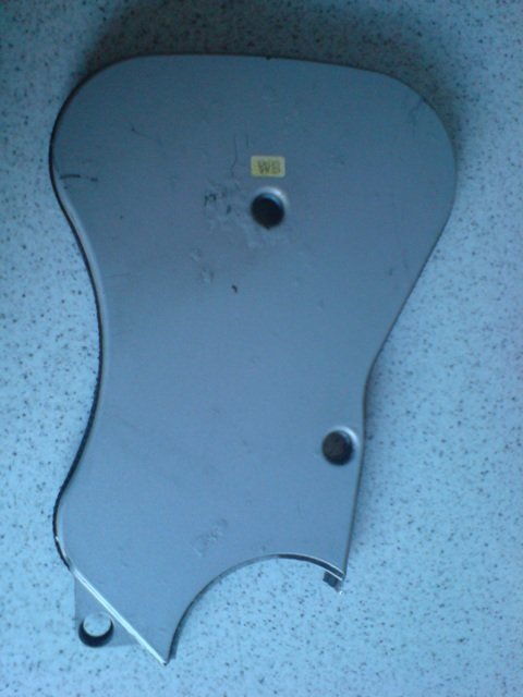

Also look at the shape of the cambelt cover!
Early -
Late -
Can't find pic, has an extra notch on the rear for a pulley
[Edited on 06-12-2007 by Daniel_Corsa]
JM_16v
6th Dec 07 at 18:13   View User's Profile U2U Member Reply With Quote
its got no cover... needs one
