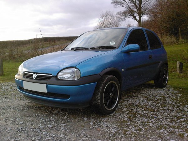

Is it bent? or just need adjusting?

headlights your problem

There are rubber grommets underneath the bonnet just above the headlights that you can adjust up or down, give them a try

ah right, easy fix?
Not even had a real good look yet.

Will have a scan. Does the general line of the bonnet match up to you?
As in the actual bonnet doesn't need adjusting?

bonnet is sittin too high over the wing

looks like that plastic clip on the lights thats prone to snapping has snapped

Reduced the rubber grommets to the min. The bonnet is lined yp with the wing, but it looks like the headlights have sunk into the bumper
Can get my finger between the headlight and bonnet with the bonnet shut.
Where bouts is that clip? Will I get a new one with a set of Depos?

These clips I think Steve was referring to are just the 2 mounts, for the headlight to physically attach to the car

steves talking about the clip on the front panel that the light slides into but i dont think hes right
the bonnet needs to come fown to be level with the 2 wings, if the rubber bungs dont bring it down enuff then you can adjust the striker pin on the bonnet to make it close lower

light looks wonky to me

the "white square" as we call them
same

yeah little white clips, 38p or something daft from vaux

Cheers, any pics?
Cheers mate. will try that

£0.40 with VAT - i bought one 2 weeks ago. imo the bonnet is spot on the headlight looks to be slanting backwards and sitting too far in as if kicked in
cheers mate.
I'm thinking it's the headlight.
Going to have a look at the weekend, see if there is anything obvious.
Cheers for the replies chaps thumbs:

this could be an idea to think about.... has it had front damage? i bought a corsa and noticed the same thing then i didnt think anything of it i just ligned it up again then when i was wiring my door speakers in the inside of the door was a different colour and i checked the underside of the wing and that also was a different colour to the original colour... just a possibility
