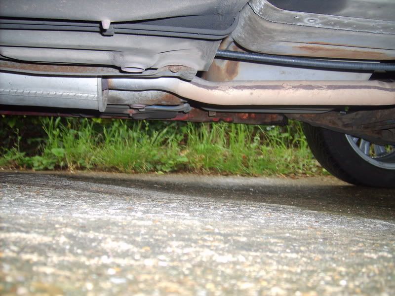

Need some advise, because it was raining yesterday I had my back box fitted at the garage. Went on a dream and sounds great but it seems like the pipe from the centre box to the back box is sagging and rattling while I drive. Any way I can make it so it doesn't sag?

they all do it - shite design unfortunatly

Dang, anyway I can make it a bit more secure?

try putting cable ties on the centre exhaust mounting rubbers to lift the exhaust up, what is it touching against?
my old sport did it when i fitted a new standard system, spent hours trying to stop the sqeakin and rattling. maybe try turning the centre section abit to the right or left.
the reason mine did it was due to it being lowered 40mm, but after turning it for ages i finally got it to stop
