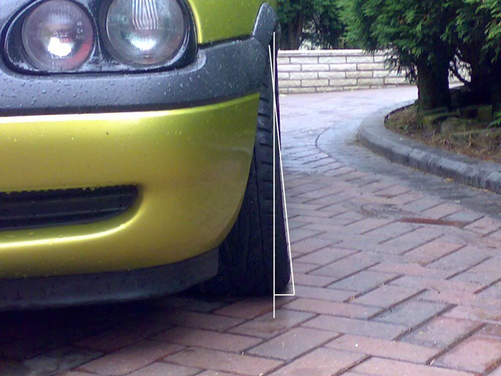

DAZ1985
Registered: 3rd Sep 06
25th Jun 07 at 18:53   View User's Profile U2U Member Reply With Quote
pic
edit - does it work?
[Edited on 25-06-2007 by DAZ1985]
Vaux Lad
Registered: 15th Dec 04
Location: Stoke-on-Trent
25th Jun 07 at 18:56   View User's Profile U2U Member Reply With Quote
Yup, negative camber.
