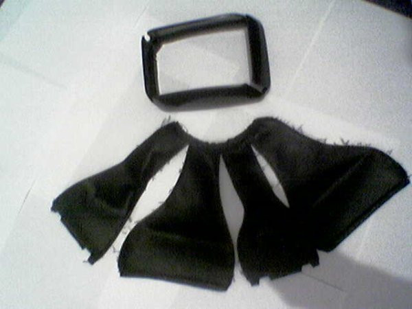

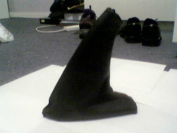

Gearstick gaiter:
this is attached/wrappred around a plastic mould. if you lift the plastic from behind the gearstick it should lift away, from here remove the staples holiding it to the plastic moulding and then remove from the shaft
Handbrake gaiter: little bit tricky. feel down the gaiters edge until you find a plastic plate, this is what the gaiter is attached to. tug hard at this and it should work itself free. carefully angle it out of the slot in the carpet and its out. Again remove the staples and then peal back the gaiter to remove from the handle itself....
shows the plastic of the gearstick gaiter
running along the bottom is the plastic to wich the gaiter is stapled
hope that helps!
