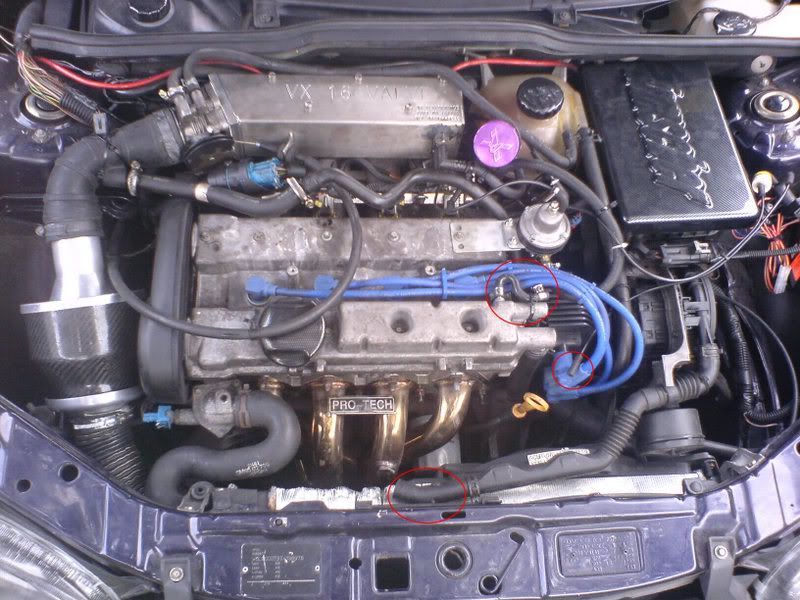

Has anyone fitted one of these to thier car? if so what have you done with the sensor to stop the engine light from coming on? i've just have one fitted and the engine light has come on. Also could it cause my engine to over rev? the car is idel at 1000k and before it was at 900k plus when your slowing down and push the clutch in it goes up to 2000k. I've just had fitted:

i've had a look in the engine and there are some pipes doing nothing and not blocked up, could it be them?

You need to remove the SAI motor, there is a sensor on there you need to disconnect. Don't worry about the others.

http://i127.photobucket.com/albums/p153/cfuk85/New%20Car/DSC00377.jpg
that one needs blocking up. and the FSE needs to be set on a rolling road so its fuelling properly.

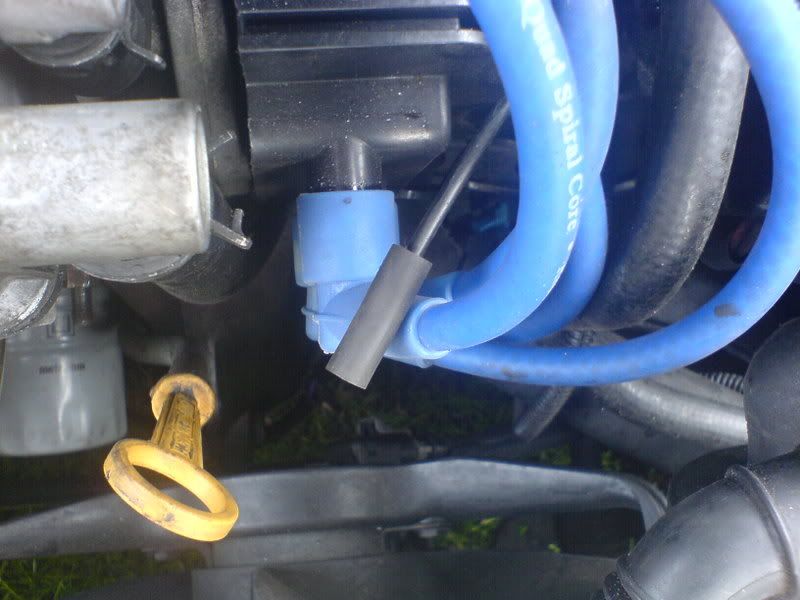

so i block this up: http://i127.photobucket.com/albums/p153/cfuk85/New%20Car/DSC00377.jpg
and take this off: http://i127.photobucket.com/albums/p153/cfuk85/DSC00375.jpg

how do i take the SAI motor off proper?
daz 16v
Registered: 12th Jun 06
Location: Pemberton, Wigan
21st Apr 07 at 12:31   View User's Profile U2U Member Reply With Quote
two 13mm bolts just holding it in place.

right i've took the SAI motor off the and and then it keep cutting out, so i've had to put it back on the car. What am i doing wrong?

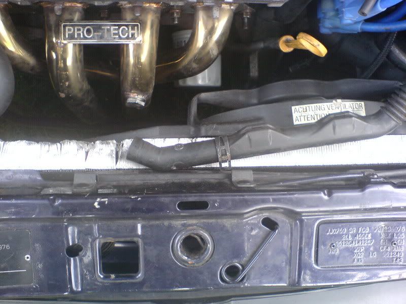

ur intake pipe is tiny!!!

the intake where it goes into throttle body just before on the curve is tiny!! get that sorted out!

i was tod that i need one for the sensor. I was told that i could get one from halfords, but i can't seem to find one. Any ideas of where i can get one?
