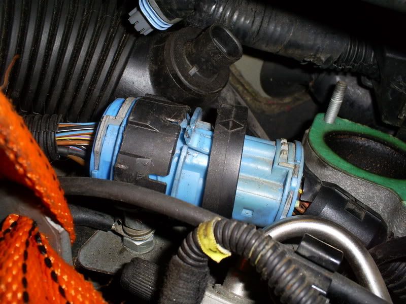

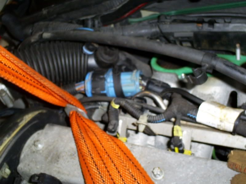

im gonna go nuts. See the pictures below. We canny figure out how to get this blue thing off wiothout cutting it off. Can anyone help please, i would appreciate it
IMG]http://i35.photobucket.com/albums/d173/saz198/p2shk027.jpg[/IMG]

get some grips and turn in anticlock wise (on the black part)

it just twists apart iirc

shouldnt be too difficult, only had mine apart the other week

you dont even need grips, bit of wd and itll twist apart

thank you all. its just one of they stupid things that you come across, which is so easy but you think its gonna be hard, if you get what i mean cheers guys

there is a lock in it mate in your first pis on the left hand side there is a gray piece of plastic you need to lift that out then it will come apart ..
