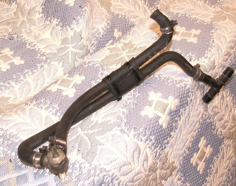

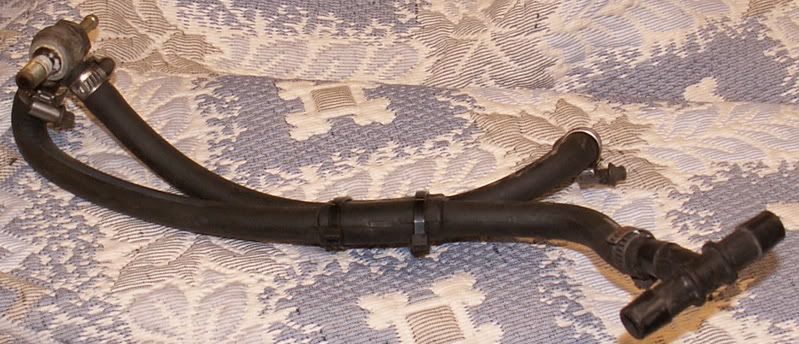

Hi all,
Found this pipe in a box of bits whilst rebuilding my C20LET - its been 3 years since its been taken off and bugger knows where it goes ???
Anyone got any ideas - pics would be great too!
Any help appreciated as usual !
Joff

The adaptor with the 2 pipes on screws into the front face on the inlet manifold below where the throttle body is, the pipe without the t piece on goes to the small outlet on the cambelt end of the inlet manifold near the alternator bracket, the other goes back to the expansion tank.
