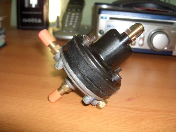

jenvey tps is fine, dont last long tho. if it was tps then he would know straight away whilst its being mapped. as for checking the fuel pressure, just take the fuel pipe off the return end of the fuel rail and stick another, shorter piece on. then plumb in a gauge.
or even easier, buy my valve that I got from sbd with the gauge on it. only used twice for setting up tb's.

does that guage stay on all the time then? or do i use it to set the pressure and then swap it for the return fuel line? looks the same as mine apart from the gauge.
how much is it?
Dave A
Registered: 10th Dec 03
20th Sep 06 at 19:22   View User's Profile U2U Member Reply With Quote
you can keep the gauge there all the time or blank that port off with a bolt.
I would set the fuel pressure to 2 or 3 bar and then adjust the injector duration to suit on the map. and then fit a fixed webber one. £45 posted rob.
cost me £25 for the gauge.

look in the top pic, you can see where its blanked off.

yes, mine is blanked off like that. i cant get to the other side with where i've put it though, so i guess i'd have to set it and then swap all the hoses around? i'll see what the bank suggests tomorrow

mine is top right, up against the bulkhead

see what you mean about the position.
is yours the type you get with the sbd kit? if so its likely to be that, they are known for their shiteness.
you can tell by looking at it, if its skinny at the base (looks like it) compared to the one in my pics then that might be to blame.
at leats with this one you know it works as you have the gauge and its hardly been used.
