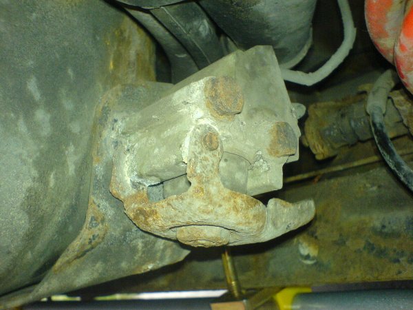

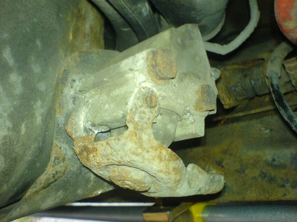

mine was siezed so while I was fitting my rear ARB I removed the spring.
which one of these pics is showing the valve with LESS braking on the rear?
top or bottom?

Im 99.9% sure I know but just wanted to check

I guess itd be the top? The spring on mine has rusted and fallen off also.

mine is 10yrs old and got pulled on mot for the first time for being seized. just sprayed it with wd40 and adjusted it and passed mot. easy fix.

The bottom one. I needed to know this the other day so went and checked under a non lowered Corsa that was parked up and the valve was up at the top like the one on the bottom pic. Spring was still attached too. so would guess that it is right?

Anyone else?? I'm interested to see if its right.
