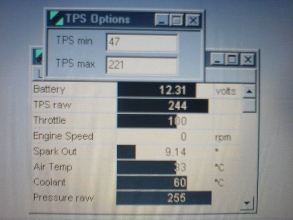

yes, the allen key grub screws with the 8 or 10mm nuts to tighten them. they adjust the balance. you can tune the balance using a vaccum gauge or a gunsons carbalancer (£10 from halfrauds). impossible without the tps set tho. what ecu are you using?

Dave A
Registered: 10th Dec 03
5th May 06 at 21:11   View User's Profile U2U Member Reply With Quote
that shows how exact the tps needs to be.
