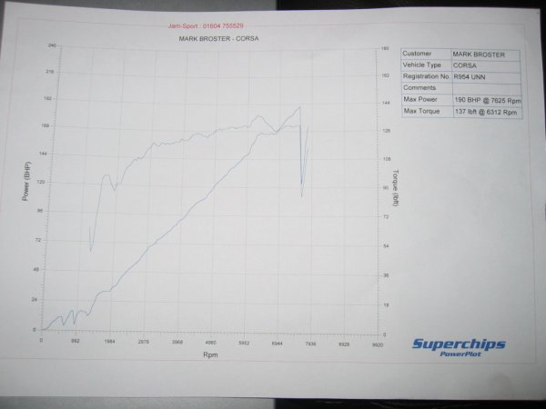

Read what I said fool. I was saying that a 4-1 manifold is a stupid idea with a standard rev limit and inlet manifold. There is obviously a hell of a lot more to exhaust manifold design than you know. There is also power past 6500, look at this:

yes power past 6500 on a 190 bhp engine on your graph not a STD one This is a std engine, where a 4 branch will make a difference where it does'nt have to be at high revs. Go do a peak power test on a std 1.6 engine, as you should know there is a BIG difference on a power curve on a 190 bhp engine and a std sport "fool" Plus this engine has std cams so the rev range power is still in mid range not on high
