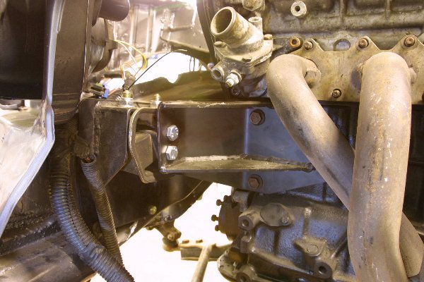

Ive got everything else covered, just a tad confused with what to do with the O/S mount. I know i'll need the "bodymount" and the MK2 astra GTE rubber block. I assume this would mate up to the normal XEV alloy engine mount/PAS pump bracket? Or does this foul something?

I dont intend to space the rear gearbox mount, just gonna grind the edge off the mount until it fits - does this effect the O/S mount at all?

would also like to see any pics that u might have of such a conversion
20th Feb 06 at 17:16   View Garage View User's Profile U2U Member Reply With Quote
20th Feb 06 at 17:17   View Garage View User's Profile U2U Member Reply With Quote
Thats without PAS bracket.

right, i see. I guess u could use the normal early style xe bracket to mount the pump on those 3 holes at the bottom. Just leaves the problem of how to run the belt really, as id have to stick with the multi-vee pulley
