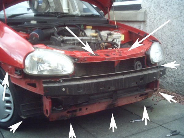

Need respray the grill in my front bumper, can anyone show me how to remove front bumper eg where each screw is or bolt and also the best way to take the grill out (ie pull hard or is there clips).

There are 9 screws holding the front bumper on :
2 * 8mm at the top of the bumper , open the bonnet to see them.
3 *8mm under the bumper
1 * 8mm at each corner of the bumper (underneath - meaning five in total underneath )
1 * 10mm under each arch , where you open a flap to get to it . This "screw" is actually a plastic nut and really hard to put back on !!
This pic shows roughly where the screws are :
The bumper should now be very loose .
Pull both the right and left arch trims gently away from the bumper , and remove the screws if you need to .
Now give the bumper a pull away from the car , and put quite a bit of force over the towing eye area of the bumper , so that it pops over it .
