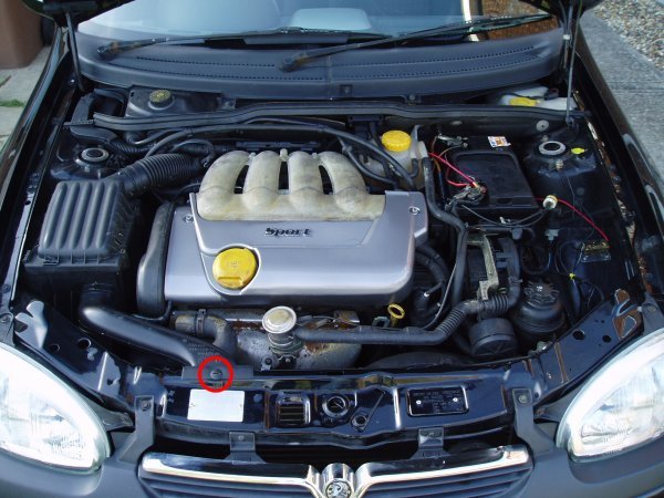

On the drivers side you may find it easier to remove the inlet pipe, just use a big screwdriver on the plastic screw which is circled, turn quarter of one full rotation then lift the pipe out, it snaps in to the airbox, you'll see how when you remove it.
