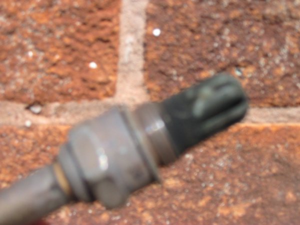

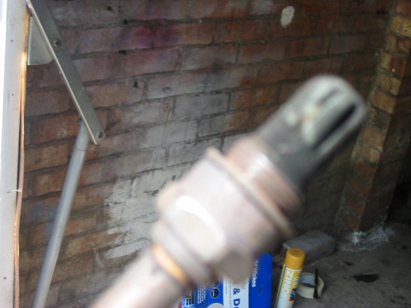

i failed on high emissions..... it was the lamba sensor, i replaced it with a new one.... and
heres wat my one one looked like
pew pew pew pewwwww
Gavin
13th Mar 05 at 18:40   View Garage View User's Profile U2U Member Reply With Quote
sorry about the blurred pics
pew pew pew pewwwww
