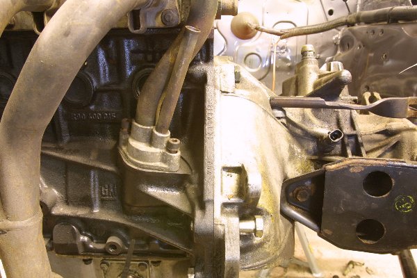

Does it look like this? (if this is the arm on the top of the box)

you'll tell because it will either be a flat piece of grey metal bent(twisted) through 90degrees with a fork at one end and the rod welded to the other; or a solid piece of cast metal painted black with a brass or zinc plated looking rod/pivot at the end.

Joff's posted the early one with the twist.
this is the later one
poor pic but the arm wasn't the subject.

yeah thats a clean snap, and old style.
