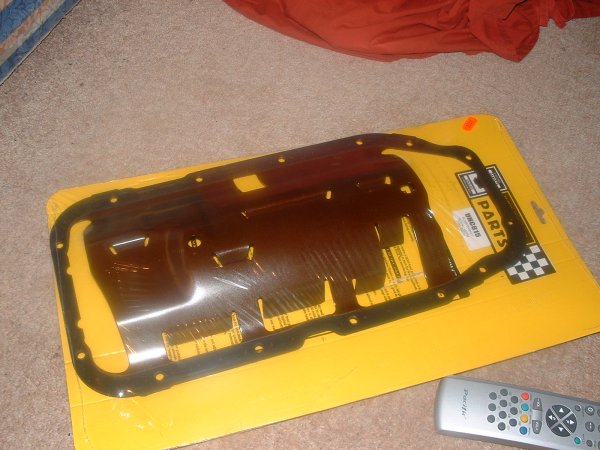

yes, also get one off the XEV, looks like this-
1st Nov 04 at 21:13   View User's Profile U2U Member Reply With Quote
So you can use the whole sump gasket set from the XEV? Or do you need stuff from the XE gasket set too? Would prefer a rubber gasket to a chocolate one really.

ive not fitted it yet (obviously) but looking at it id say it just goes straight in. The baffle plate bit is sort of molded into the rubber gasket bit

it doesnt. I presumed it was a leaky sump as this is very commom fault with the original cork gaskets.
