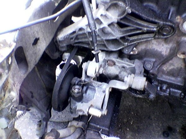

It'll be the power steering pump/drive belt... Dad's astra did it, even our new Corsa C does it, just one of those things...
were EXACTLY is this!
i didnt know their was a belt on the pump
It is located by the front engine mount on the drivers side:
This is on a 20XE engine though... But will be in roughly the same place...
11th Aug 04 at 23:29   View Garage View User's Profile U2U Member Reply With Quote
Common problem then!
When you say its the belt - what specifically? Too loose so it slips when its under most load? Reckon a new belt would cure it? There is also adjustment I assume?

the belt is on a tensioner so it shouldnt be that the belts loose
