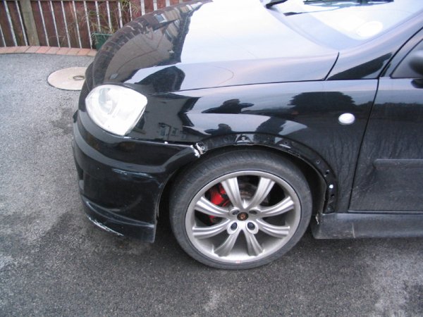

very upset, hit sumin in the road and it did this

how would you go about reparing that then? i dont know what it was.. i think it was an animal.. but i heard it go bang!

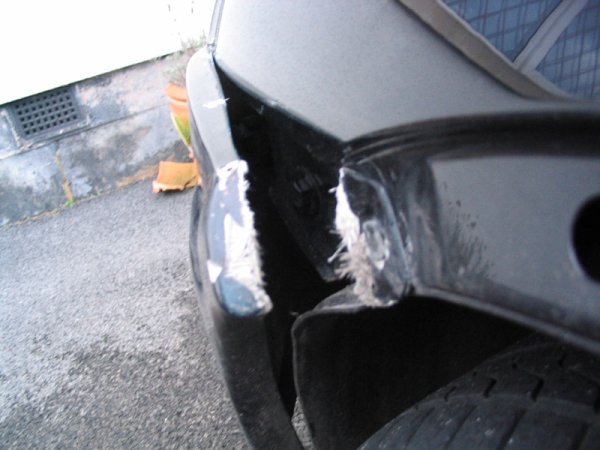

by the looks of things its just the mounting point on the back of the bumper with has cracked, just take bumper off and fiberglass patch it , of maybe use some meshing to make it stronger
easy fixed wouldent even have to paint the bumper

take the bumper off and take pics of it better, like how it supose to look and stuff and can tell u

thats basically it bud. ive got some more pics from different angles ill go get em..

Yeah u can fix that easy m8. Might want it repainting tho to get rid of the scratch, if u do ask a bodyshop, they'll prob repair it free whilst paintin it.

take bumper off, put some fibreglass resin between bumper and broken bit and stick it on.
Then put a couple of layers of fibreglass mat on the inside of the bumper to firm it up. Smooth out the crack (if there is one with top stop) and respray over it.

tbh m8 for the hasle get a bodyshop to do it and respray the entire bumper whilst its there. Wont cost over £80.

will not need painting by the looks of it as its behind the bumper the bit that cracked

Yes but there is a bloody great scratch on the bottom of the bumper that i cudnt live with.

Piss easy as Beardy says, but seeing the other picture, u'd want the whole thing resprayed.

the bumper has the scratch at the bottom and 1/2 way up then the damage to that joing and it is FULL of stone chips!
