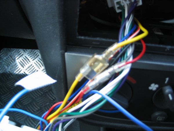

got me a new head unit lst night, fitted it but.. its loosing its saved memory,
there is a yellow wire and a red wire and i have tryed them standard (red in Red and Yellow in yellow) and this didnt work,
so i tried red in yellow and yellow in yellow, but his didnt work either,
i have to try red in yellow and yellow in red but i dont wanna damage anything,
does anyone know what s up wiv it?

you have to find ya permanat live think its the yellow one, both red and yellow are live so dont worrk about them touching, if i remember you have to wire a red with a yellow to the yellow, something like that

one of then is pernament live for the memory and 1 is ignition live/switch live
swap them over/around and this will sort it
it also says in the manual for the radio how to do this

put yellow with red and red with yellow, job done.
