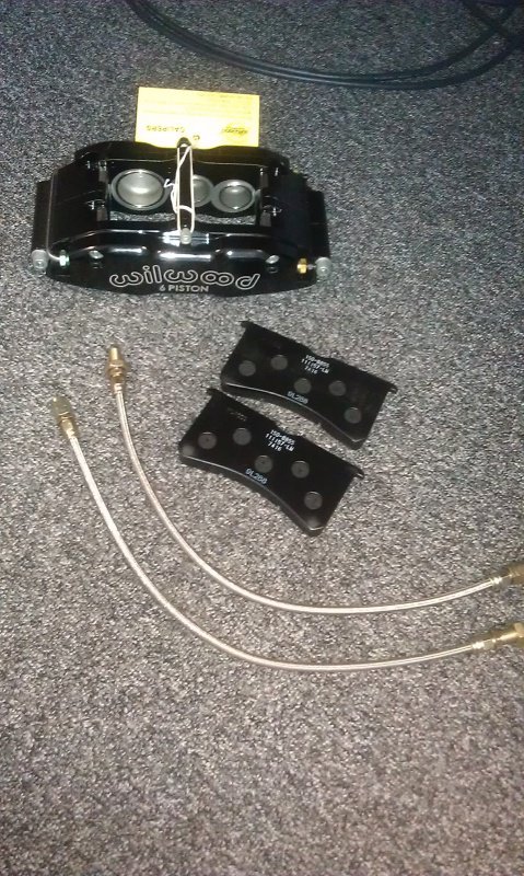

well that could have gone better the fuckers have sent me 2 right hand calipers and its the weekend now

the 4 pots i've stripped/rebuilt before had aprox pistons of 20mm radius.
So total surface (piston pushing on pad) area = 5026mm2
That Willwood looks to have 1 large and 2 small which possibly makes better use of the available space (think about cutting circles in card and the most efficient/least wastefull way to do it)
Say 1 40mm piston, and roughly 2 x 30 pistons. If that is the case its got aprox 5313mm2
they have bleed nipples top and bottom so how are they sided?
AK
Registered: 5th Jul 00
Location: Aberdeen City
10th Jun 11 at 17:41   View User's Profile U2U Member Reply With Quote
they have only bleed nipples on the top.
Air RISES
AK
10th Jun 11 at 17:42   View User's Profile U2U Member Reply With Quote
i'll rephrase that a bit....
Air is lighter than brake fuild so will go to the top of the caliper.
You cant bleed a caliper properly from the bottom.
EDIT: Going by the pic you could alter a caliper to fit the other side but you should not have to do this on a L/R complete kit. If you damage a thread its your fault
(move the bleed nipples to replace the link)
[Edited on 10-06-2011 by AK]

you cant swap it round because it has the different piston sizes though

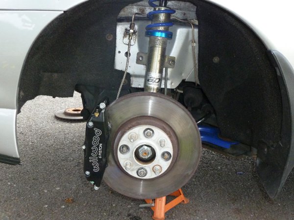

10th Jun 11 at 18:55   View Garage View User's Profile U2U Member Reply With Quote
having to send one back next week. fitted one side though
loads of room need to cable tie the brake hose back
obs cant test yet
re: pedal test etc, i will try and see, i 'think' the focus 170 uses the same master cyliner stock, had the 170 stock setup on there anyway and that was ok so im assuming if its ok as a direct replacement for that it should be fine
[Edited on 10-06-2011 by Steve]
10th Jun 11 at 18:59   View Garage View User's Profile U2U Member Reply With Quote
couple of questions, iv had to use 2 or 3 washers in between the caliper bracket and the hub carrier as the caliper wasnt quite centered over the disc, is that ok like that? or is it wise i seek one 5mm thick shim to use instead of several washers?
secondly as you can see in pic 1 the pads dont cover all the disc, theres about 10mm or so of disc uncovered, all the pad is on the disc theres non sticking out the top so im assuming that gap is there for discs that have bell houses??

10th Jun 11 at 19:30   View User's Profile U2U Member Reply With Quote
don’t use washers unless they are machined flat, but tbh even then you’d be better off with a proper spacer, and yes the pad contact is fine, would be different with alloy belled discs, as long as all of the pad is in contact with the disc its fine
