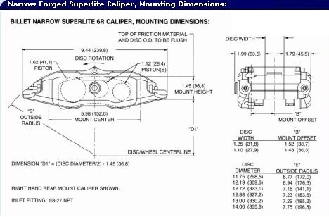

I agree, if the measurement from opposite edge to outside of caliper is 340 on a 300 disc surely this is 380 diameter set up? However if he says it fits it's his problem if it doesn't, sounds like he's not explaining the measurements clearly, 40mm seems quite a lot of projection of the edge of the disc.

Tbh it's easier to explain as a radius like AK said, a better measurement would be from the centre of the disc to the extreme edge of the caliper. Double this and that's the diameter of wheel you need to clear, not taking into account any possible spoke interference which can usually be overcome with spacers.

only thing i can think is that the caliper doesnt protrude by 40mm and that it only does by 20mm and they are factoring in that hence the 40mm total
40mm does sound like an awful long way for a caliper to protrude away from the edge of a disc

go measure them for me lol, and we'l just knock 15mm off the radius

My 4 pot alcons stick out 22mm from the outside of the disc, just to give you an idea.

finally found some definitive info
radius for a 300mm disc is 172mm = a 344 wheel needed
looks like AK was right
